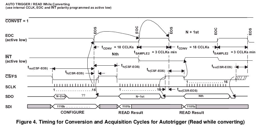

hi i need help on adc8329 converter.
if anyone can comment on what is the correct sequence to configure.
and who sent you the cmr cfr followed and nothing happens.
there is a sequence of settings?
I put it in automatic mode shooting.
sorry for my English is google translator.
