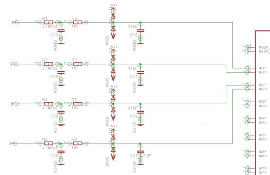

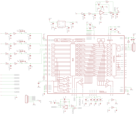

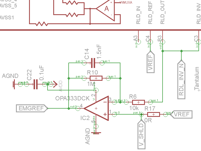

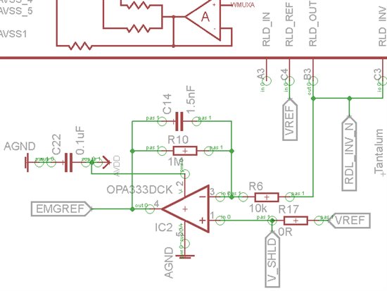

    About the interfacing of the electrodes to the input channels, I followed the specifications in the datasheet and in the application notes. I attached below two screenshots of the schematic of my circuit, so that you can see how I did it. This schematic was designed to acquire signals from two muscles. The tag V_SHLD in the RLD circuit refers to an external shield connector of my EMG setting. For the diodes in the inputs, I intend yo use BAS40XY, meaning you can use oine package per channel. If you have any further doubts, please feel free to ask.

    Looking at your design I notice that you use a 2nd order RC filter at the inputs, those values you selected are the sames values showed in the RLD datasheet, but the cut-off frecuency of this filter is close to the 135 Hz, witch is appropriated for a ECG application, you should consider using another filter according to the frecuency range of your sEMG application. Take a look on this:
    http://e2e.ti.com/support/data_converters/precision_data_converters/w/design_notes/the-ecg-and-eeg-frequency-range.aspx

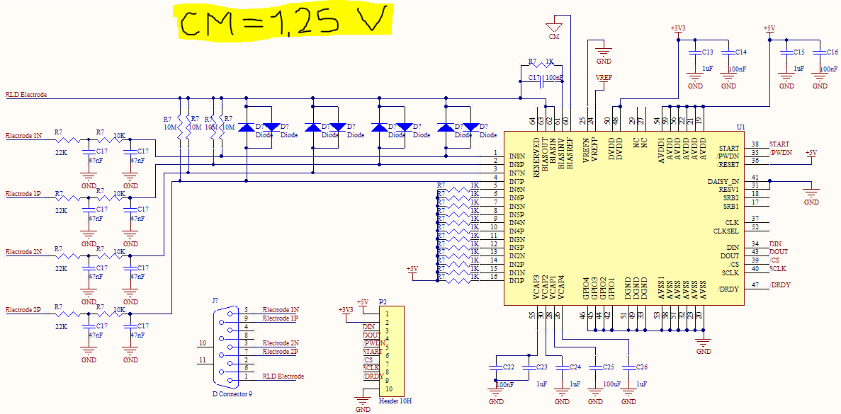

    I'm also not using those clamp diodes as patient protection, instead i'm using an anti-parallel diode configuration between each input and the reference electrode. As show in the next image:
    This is my overall configuration without the reference and power circuits. As a second intention I'm telling you this to ask you how great is your advance in your project design. Have you passed to a testing stage? Any suggestions?

    it is prabably a bit too late to reply now, but I havent been working on this project since January. However, someone else tested the system assembled using the final schematics shown in the picture below, and they worked fine.
    The hting you mentioned about the cutoff frequency makes sense and you are probably right, I guess I should have used a larger cutoff frequency, however, the puspose of the project was to evaluate slow walking movements, so I guess in the end it wasnt a big problem. The noise present in the system was filtered by post processing so the cutoff frequencies were not a big concern. The interest was to see if the circuit design worked, but i dont know how the SNR ratio was because i did not test it personally. Note that I used schottky diodes and small package components.
    I realise there may be better configurations, and I wonder if your antiparallel setting had better results. I dont have further suggestions but good luck in that :)
