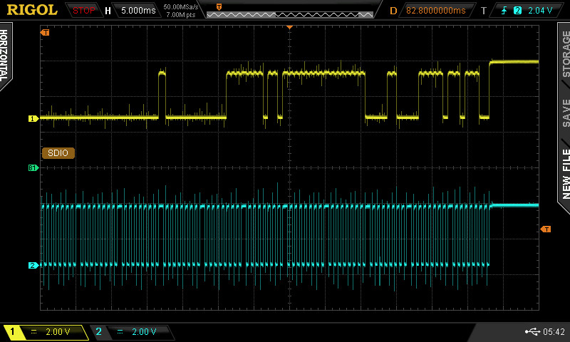

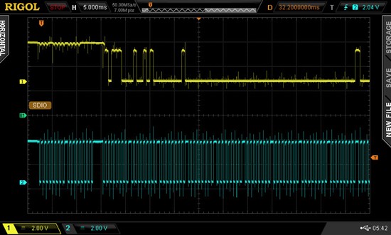

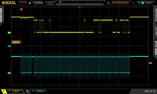

  • My readout
    ./readReg.py
    Reg  0x00: SETUP  0x4a
    Reg  0X01: MUX    0x1
    Reg  0X02: ACR    0x0
    Reg  0X03: IDAC1  0x0
    Reg  0X04: IDAC2  0x0
    Reg  0X05: ODAC   0x0
    Reg  0X06: DIO    0x0
    Reg  0X07: DIR    0x0
    Reg  0X08: DEC0   0x80
    Reg  0X09: M/DEC1 0x7
    Reg  0X0A: OCR0   0xf6
    Reg  0X0B: OCR1   0xff
    Reg  0X0C: OCR2   0xff
    Reg  0X0D: FSR0   0xc
    Reg  0X0E: FSR1   0x3e
    Reg  0X0F: FSR2   0xdc

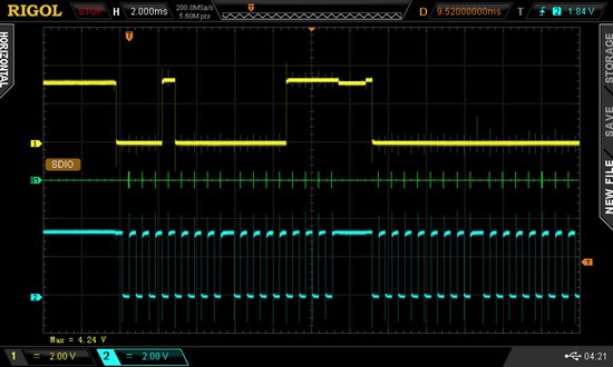

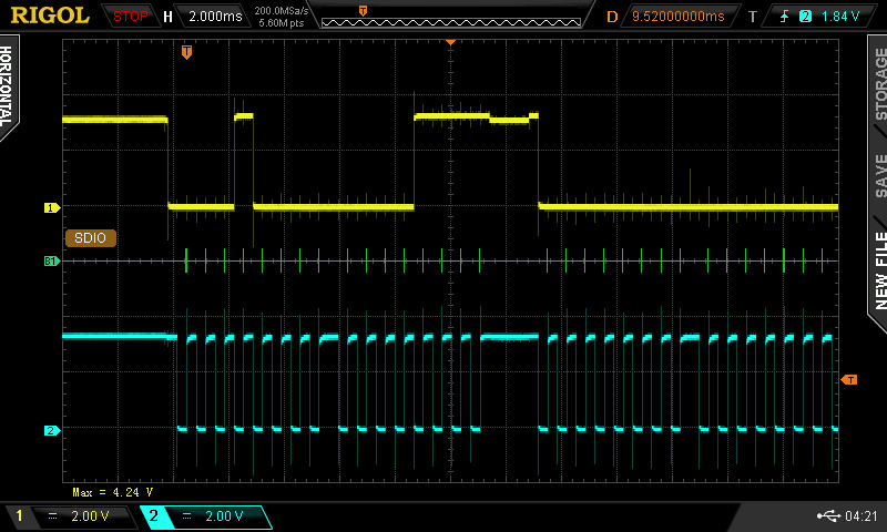

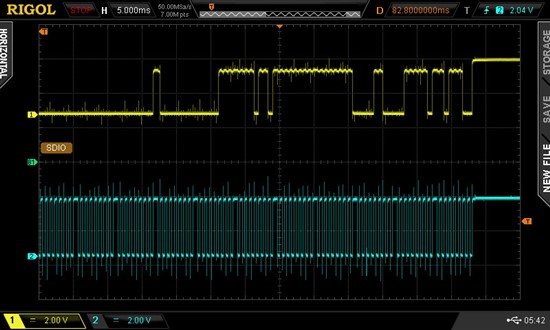

    Scope: Clk, Dout
    Scope: Clk, Din
    Zoom in - first part
    Zoom in - second part
  • Hi Klemen,
    Thanks for the scope shots.  The Dout seems to be ok, but I do have concerns about the data coming into the ADS1218.  Notice how the Din appears to drop in voltage level when clocking starts.  I don't believe that the logic high is even a valid logic level for the device (0.8*DVDD).
    I think you may have some connections issues.  You should not see the voltage level drop on the communication.  Also, based on the calibration registers it would seem there are some issues with the reference connection too.  This might also be caused by a poor/inadequate ground.
    Are you using a proto type board, or an actual PCB?  Can you send me your schematic and layout?

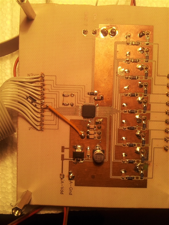

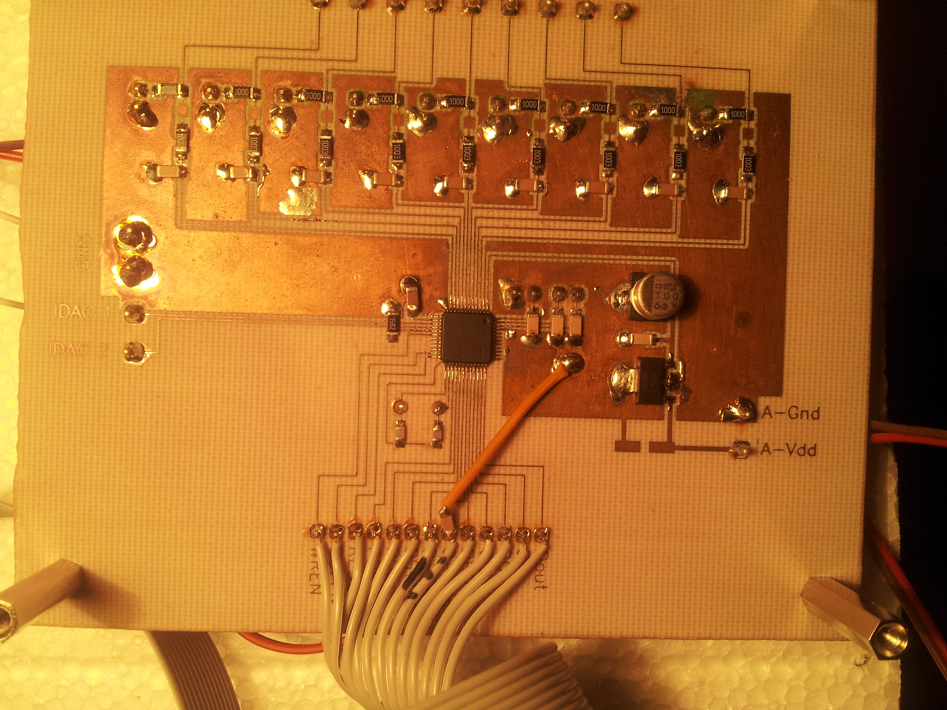

  • Thank you for your reply,
    The ads1218 is soldered on pcb and the communication and power supply lines are wired through the protoboard to BeagleBone black which is used for the communication.
    I made a photo of the pcb (i don't have the schematics since there are just few components on the pcb). The ground is joined below the ads1218. The three 1206 capacitors right to ads1218 are 100 nF and one 1206 capacitor left to ads1218 is 1000 pF. The Vref+ and Vref- lines are joined to Vrefout and Gnd using two jumpers (the pads can be seen just above the capacitors). I hope this explains the layout clearly enough.
    Klemen

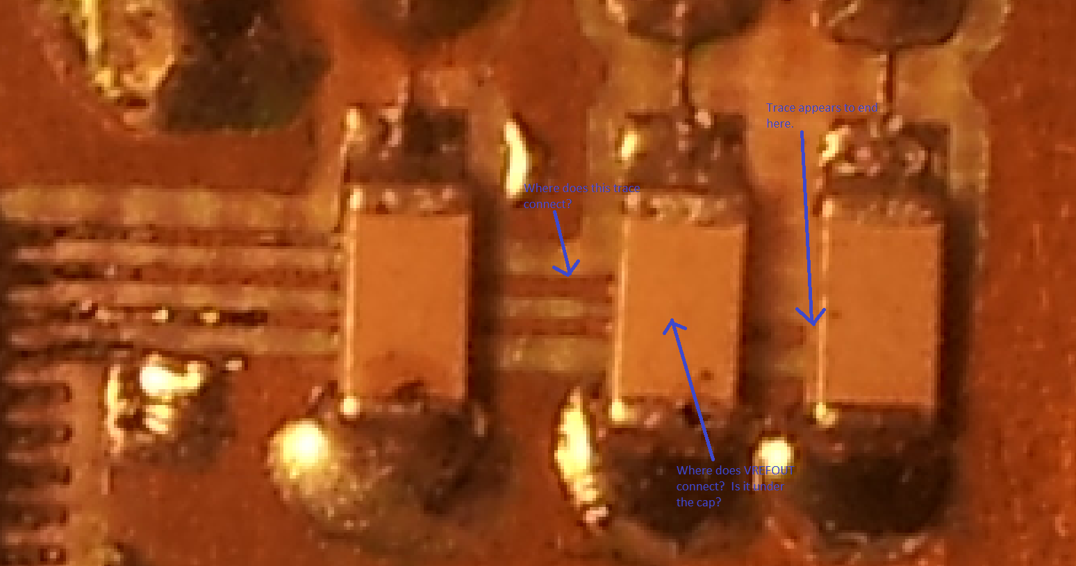

  • Hi Klemen,
    You have a very well organized layout, but it is inadequate for high levels of 24-bit performance. To get a better idea regarding what I'm talking about please see the layout information on the E2E wiki:
    http://e2e.ti.com/support/data_converters/precision_data_converters/w/design_notes/grounding-techniques.aspx
    Primarily you need to be concerned about return currents.  I'm also a bit surprised the crystal starts.  Often times the small trace for the cap ground is insufficient to start oscillation.  I would suggest adding more ground area on the opposite side of the board to create a plane.  Also widen the digital ground trace to reduce inductance.
    One thing that is not clear to me is the reference connections.  I assume they connect to the caps, and also to the jumpers.  I don't see where the VREFOUT connects.  Is it directly connected under the center cap?  The trace appears to just end between the center and rightmost cap.
    Bob B
    The traces you marked make a 90 degree turn up below the cap and are wired together with a jumper on the other side of the board. I see now that a didn't put enough effort into a pcb design. I will make a new one - i will let you know if that solved my problem :) Thank you very much for your help and your time!
    Klemen
