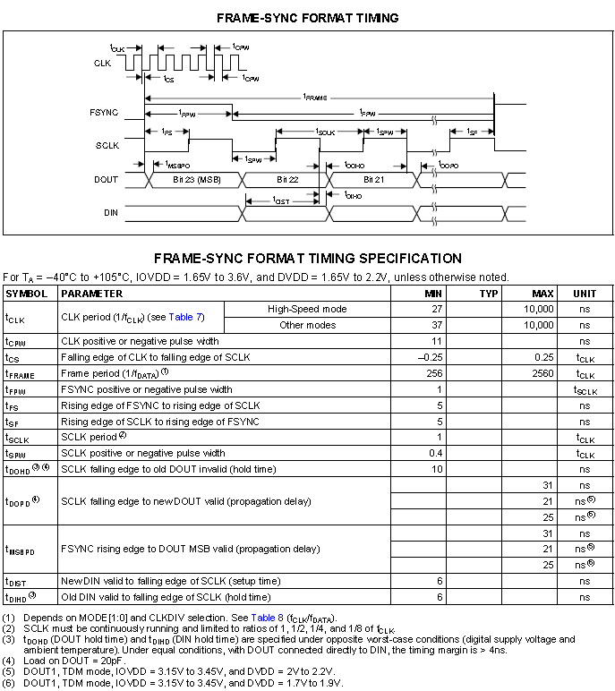

ADS1278 Timing for High Speed Operation & IOVDD @ 2.5V
Other Parts Discussed in Thread: ADS1278
I would like to Interface to the ADS1278 in High Speed mode with a 37Mhz (27ns period) clock freq.  Page 9 of the data sheet specifies a 21ns prop delay with IOVDD at ~3.3volts and DVDD at 2.1.  I would like to operate with IOVDD at 2.5volts.  From the data sheet I see we get about a 6 ns setup and 10 ns hold time with a 27ns SCLK period. What will the part provide at IOVDD of 2.5V?  What is the 31ns timing value for tdopd in the timing table?
