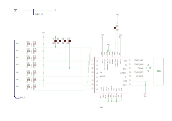

    I have drawed a circuit and I have chosen the "voltage divider " for 7 analog signal(0-10V).
    I have a MCU with SPI interface to control the ADS1148, VCC is 3.3V. Can you give me some suggestion about the circuit, whether the circuit has the right connection?

    Please review the link I sent before.  You cannot make single ended measurements with a unipolar supply with the ADS1148.  You also need bypass caps, and there needs to be a cap across VREFOUT and VREFCOM, and VREFCOM should be connected to ground.  The internal reference is limited to 2.048 volts, so the input voltage divider must be calculated to stay within that range.
    Bob B

  • I have changed the schematic as follow:
    I need 4 channels(AIN0,1,2,3) as my analoginputs, AIN7 is to GND. the RESET_ and START are to VCC(3.3V).
    How can I choose the Channel one by one in a loop? I want to read my 4 Analoginputs one by one continously. I have written somes codes as follow, can you give me some suggestion?

  • thank you very much, you are right! I forgot the Pin "DRDY", I should check it to kown the transition's situation.
    I am confused about the schematic, how can I connect the input signal to ADC1148?
    You told me in the post of Dec 03 2012 20:22 PM as follow
    "you need to set one input to ground (for example AIN7 should have the mux connection to AINN) and the other inputs connect then to AIN0-AIN6 to AINP."
    sorry that I have too little experience about "ADS1148", how can I connect AIN(0....7) to AIN(N/P)? there are no AINN and AINP pins in ADS1148.
    have drawn the schematic again, I used Single-Ended Inputs to measure analoginpus(0...10V), I have used voltage divider to reduce the inputvolt to maximal 2.048V
    If AIN- cannot be connected to ground when using AVSS connected to ground, how can I connect my analoginputs to ADS1148? I look forward to your answer.

  • Lidong,
    From the same post you cited I also stated the following:
    The other issue is the common mode restriction of the PGA.  The only way you can get a measurement to ground (0V) is to use a bipolar supply.  See this Design Notes page for further information:
    http://e2e.ti.com/support/data_converters/precision_data_converters/w/design_notes/1370.input-voltage-range-requirements-for-the-ads1248-and-ads1148-families.aspx
    If you take a look at Figure 51 of the datasheet you will notice that the mux can be switched in a variety of ways.  The input to the PGA is shown as a differntial input of AINP and AINN.  This means that for a positive value for the output code the relative value of P is greater than N.  For the MUX0 register settings, the P (positive input channel) corresponds to MUX_SP, and the N (negative input channel) corresponds to MUX_SN.
    One possibility for attempting to read single ended inputs for a unipolar supply (AVSS connected to ground) is to bias the analog input for AIN7 to a value above ground.  For example, you could connect AIN7 to VREFOUT.  Now the differential measurement will be different as at 2.048V (with AIN0 equal to 2.048V and the AIN7 also at 2.048V for example) the differential resultant code will be zero.  In this case you need to make a calculation where  you subtract the output code from the full scale code value to achieve the correct value.  2.048V - 0V = 2.048V is the example we just used.  In hex you would use 0x7ff - 0x0000 = 0x7fff.
    There is one problem, and that is when your input is below 0.1V as this places you outside the common mode range of the ADS1148 (assuming a PGA gain of 1.)  However, in most cases that should work out ok if your signal is mostly above 0.1V.
    Bob B
  • hello Bob,
    thank you for your help! I have changed schematic and tried ADS1148 again. Actually I need only 4 Inputs for my project, I give the 4 inpus(AIN0 to AIN3) the same signals (about 0.5 to 2V after voltage divider), the signals are from the same voltage source.
    I got the different values from from AIN0 to AIN3, why?

    the schematic is as follow:
    Can you give me some suggestion? or Is there somethingswrong in my schematic and thread task?
    I look forward to your answer!

  • Lidong,
    I see you have VBIAS turned on for each measurement.  Keep VBIAS at 0x00, as this voltage will create a problem by creating an additional current path, especially at the lower voltage inputs.
    It is not totally clear if you are applying the input voltages described directly to the ADC input, or through the voltage divider.  If you are placing the input through the voltage divider, the resistors need to be very well matched or the variance in the resistor tolerance will alter the result accordingly.  Another issue is you are setting the data rate to 2000sps.  This will have some code variation due to noise.  Another possibility is the stability of the voltage source.  If the source is noisy, you will see code variation from reading to reading.
    As you also have a filter at the input, you need to wait for the analog inputs to fully settle before making the measurements.
    There also appears to be a calculation issue with respect to the codes you are using.  With a 2.048 voltage reference, the LSB size is about 62.5uV.  If I assume that you are applying 0.644V directly to the analog input of the ADS1148, that should result in a code relative to ground of about 10304 (0.644/62.5uV.)  However, the resultant code is not referenced to ground, but to 2.048V.  This means you should get a negative output code.  The actual input should result in a difference of -1.404V.  This should be -22464 codes.  Positive full-scale is 32767 codes.  If you take full scale and add the difference (32767 + (-22464)) you should get the value relative to ground, which is 10304.  The result you are getting is much different.  Here you have to be careful that you maintain the correct sign.  If you use a signed short for your data result you should be ok, but if you use a signed int, then you need to sign extend appropriately.
    The calculation of the result should be the total counts times the LSB size.  This value will be greater than 32767 for all input voltages greater than 2.048V and less than 32767 for all voltages less than 2.048V.
    First thing to do is make sure VBIAS is off.  You should then verify your computed data with results by monitoring DOUT with an oscilloscope.  They should match by both computed and hand calculation.
    Bob B
