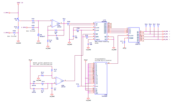

    Below are the schematics for the ADC part of my design (if you can see anything...). I feed the analog signal through a buffer and the output is fed to a D flip flop. Since I need to interface with low speed circuitry, use a divide by N counter to divide the clock from the ADC and clock the Flip Flop from here. Also you will see a simple circuit generating an initialization pulse of a few microseconds, as required for this converter to start up in free running mode.
    As I mentioned before, the circuit converts just fine; no other issues than this.

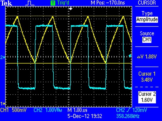

    Thanks for the answer. In the mean time I also sourced a couple of ADC0804 aswell but havent yet been able to test them. In any case, I have already tried two and got the same results and after your message I wouldnt expect any change. I think the reason for this discrepancy is due to the threshold voltages of the Schmitt trigger in the clock circuitry of the ADC. From the datasheet:
    VT+ =  2.7V (min) / 3.1V (typ) / 3.5V (max)
    VT- = 1.5V (min) / 1.8V (typ) / 2.1V (max)
    Now see attached scope capture. In my circuit the positive threshold voltage is 3.48V while the negative is 1.6V. If this values are used to predict theoretically the clock frequency, a value of approx. 420 KHz is obtained, which is much close to what I am actually getting. So in my opinion, the threshold voltages of the Schmitt trigger that are at the edge of spec are the root cause of this discrepancy.
    Hope you will find this information useful.
    Pablo
  • Pablo,
    Apologize again for the delay. I needed some time to validate your hunch and it appears that you are correct. Indeed the Schmitt trigger threshold voltages are at the margin of the datasheet limits. But what I confirmed is the Schmitt trigger oscillation frequency equation (1/1.1RC) in the ADC0804 datasheet is incorrect. The actual nominal equation is more complex and depends on VCC and the threshold voltages Vt+, Vt-. For equation see App Note SNOSBC7, section 1.1 Clock Inputs (link below).  It appears that you have found this out already as well. When using that equation the frequency that I see (and that you see) fall within the nominal frequency given component tolerances and the nominal nature of this equation.
    So to summarize initially you expected to see about 600kHz based on the component values and I'm assuming the 1/1.1RC equation in the datasheet. But we have found that that equation is incorrect. If we use the correct equation what is expected and what is actually seen align. Thanks for working through this with us. I will put in a request to update the datasheet with the correct equation.
