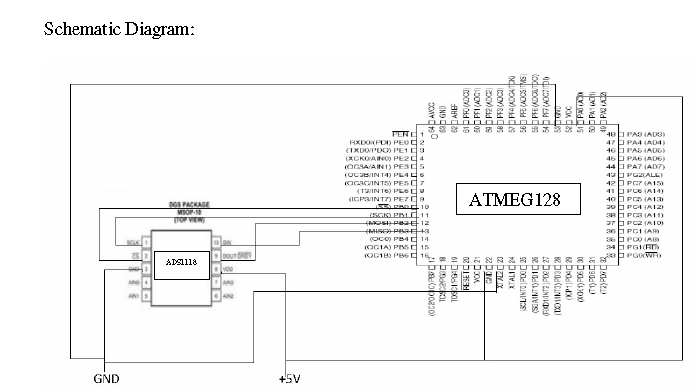

    You can try forcing the device into continuous conversion mode by changing to 0x82 instead of 0x92.  SCLK should dwell low.  A scope shot would be helpful of the communication for verification.  Can you send me your schematic?

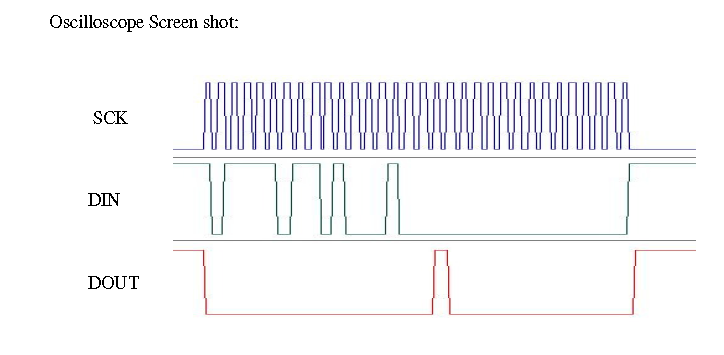

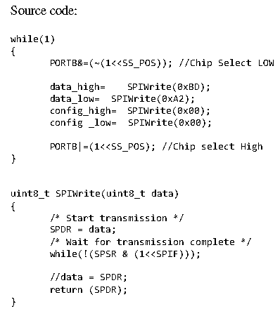

  •  yes please send the code for MSP430. Meanwhile i will send you the scope shot and also the scematic.
  • Hi BOB,
    I am sending you all the information which u asked, I have also tried a pull up resistor with SCK and DIN but i got the same result.I am running the microcontroller in 1Mhz speed. And the SPI speed is fclk/128.

  • Hi Navaneethan,
    I will make an assumption as your description is in conflict with the schematic.  The assumption is you drew the schematic incorrectly based on the scope plots.  One thing not shown in the scope shots is the CS line.  I will again make an assumption that it remains low throughout the entire communication transaction.
    From the scope shots it appears your communication is on the wrong phase.  The data should change on the rising edge of SCLK and not the falling edge.  See Figure 1 of the datasheet.  The ADS1118 latches the data on the falling edge of SCLK, so if the data is not stable you will not communicate correctly.

  • Hi Bob,
    Thanks for your reply.
    Yes i made mistake while drawing schematic. The connection description is correct. CS pin is low throughout the communication as you can see it in the source code.

  • Navaneetha,
    It appears that your clock is in the correct phase now.  The scope pictures show the data written to the config register is 0xBD82 and not 0xBDA2 as you showed in the code snippet.  Try writing 0xBC92 instead.  This should start a conversion, go to temp sensor mode, and run continuously.
    What I don't understand is why you don't see the default configuration.  The configuration is returning 0x0800.  Also, make sure you have good ground and power connections between the micro and the ADS1118.  Do you have a bypass cap between the ADS1118 DVDD and ground?  Is it possible for you to send me a picture of your testing setup?
