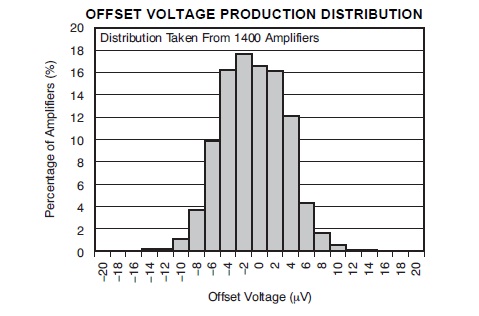

    For Leakage current,  there are big diffrence bitween "40 x min" and  "40 x max".
    Please see the below picture as my image.
    Customer need like this information .
    And how about supply current (Positive-supply current "data sheet P3") ?
    There is max value of 0.75uA (Full temp) under the condition of " V+=3.6V and VIN=0 or V+".
    Is this condition of max of supply current ?
    If VIN =1.8V , will be supply current decreased from above condition's value ?
    Ryuji Asaka

    Request Data:
    Customer' request is 3σ of below Leakage current parameter at over 10 lot.
    Data Condition, Ta=85℃,  V+=3.6V
        -No off leakage current
        -COM off leakage current
        -COM on leakage current
    Target spec :
     Analog Switch TOTAL Leakage Current≦110nA/1 current measurement unit
     TOTAL Leakage current =1 * Ino(off) + 41 * Icom(off) + 1 * Icom(on)
       If 3σ=2nA, customer’s calculation is as below (for example).
       1*2nA(Icom(on))+1*18nA(Icom(off)max)+40*2nA(Icom(off))+1*2nA(Icom(on))=102nA

  • Hello Andrew,
    Complement about request data.
    I posted that request data is distribution.
    But I confirmed 3σ value is ok as customer's request data.
    Then, customer can estimate total leakage current.
    For example,
        -No off leakage current   : 3σ =2nA
        -COM off leakage current   : 3σ =2nA
        -COM on leakage current   : 3σ =2nA
    Ryuji Asaka

  • Hello Ryuji-san,
    I apologize for the delay in response to this.  I have looked into the char data and discussed with the team on how this data is taken.  There is no distribution data taken for this parameter.  It is measured across temp and process to find a maximum value.  A "buffer zone" is then added to these values to ensure no units reach the customer outside of datasheet values.
    Andrew
