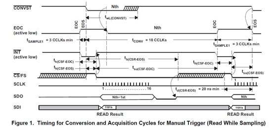

There are some nice figures on page  13 with using the device in manual trigger mode, I think my next step will be to try managing my commands around this figure, although I am confused where I do get my conversion result back? and with what timing.

    I tend to the opinion this particular Figure 1 is wrong in some points, please could oyu review it for me? Meanwhile I fight the rest of the millions of problems i am having with the ADS..
