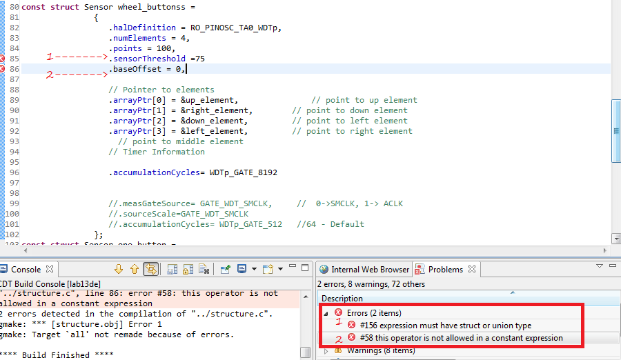

Hello, I´m trying to define a wheel capacitive sensor. I previously checked a couple of examples  on slac490 zip file and I found the CapTouchBoosterPack_UserExperience example and it define the sensor as follow:

Previously I made the characterization and works  well, but when I enable  ILLEGAL_SLIDER_WHEEL_POSITION and  WHEEL definitions in the file "structure.h" and add .points and .sensorThreshold variables, CCS  indicates the following compilation errors:
Have you any idea what may be happening?

  • Juan,
    You may need to turn on GCC compatibility in the Properties menu. Project >  Properties > Build > Advanced Options > Language Options > Check Box "Enable support for GCC extensions (--gcc).
    Let me know if this helps.
    Brian
  • Brian,
    I checked the project properties and the GCC compatibility  is enabled. To solve this problem I had to add the libraries from the example application  to a new blank project, even the "structure.c" and "structure.h" files, to make work my application  and being able to continue working in my project. I´m still wondering what was the problem, probably I made a mistake when I was trying to define the sensors.
    Thanks for your time.
