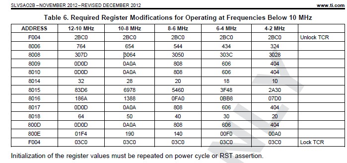

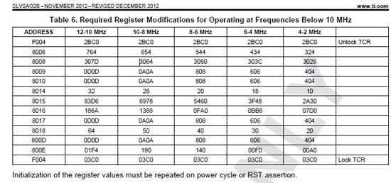

  • Ryan,
    The 10Mhz is relative to FCLK.   Operating below 10Mhz requires config changes.
    SPI clock can be any frequency, as long as it is less than 5/6 of FCLK.
    Here is the section of the draft datasheet that will include the details.  There are several updates underway, and this should be on the web early in Jan.
    Provisions for Operating With fCLK Frequencies Less than 10 MHz
    The SM28VLT32 uses a state machine and registers to implement the correct algorithms for programing, erasure
    and validation. The register values define counters and loops that determine appropriate setup and hold times,
    maximum attempts, pulse widths, and other critical parameters. The default values of these registers are defined
    for fCLK operation in the 10 MHz to 12 MHz range. Operating below 10 MHhz requires changing key registers to
    properly implement the algorithm. See Table 6 for register settings for specific fCLK ranges. Note, the 10 MHz to
    12 MHz values are provided, but are not required to be written as they are the reset defaults. Additionally, the
    SPI SCLK frequency must be 5/6ths of fCLK or slower for reliable operation.
    The values below represent the address and value that should be written using the 1D command. Note that first
    line is a write to F004. This must be first, as it unlocks the test control register and allows modification of the
    memory mapped registers. Without this write, the contents of the register would not change. It is recommended
    to follow the register writes with a read to verify that change was properly implemented. The last line is a write
    back to the test control register to relock it preventing accidental modification of the registers.

  • Hi ,
    This information is very useful. I have got communication to work with FLCK = 12MHz, SCLK = 6MHz but would like to lower the chip clock rate to save power so need to change it to 4 - 2 MHz.
    when it says "Initialization of register values must be repeated on power cycle or RST. Does this mean every time I turn of the Flash or reset it, I need to have the clock set to 12MHz send the above commands before changing the clock back to the lower frequency?
    just to confirm the above command would be sent as follows 1D 00F004 2BC0 , 1D 00 008006 0324 ....... ending in 1D 00F004 03C0. after the last instruction is sent , the clock can then be changed to 4 - 2 MHz ?

  • Hi Wade,
    Thank you for your help. just confirm when you say "You must set the configuration before using the device for any operation". Does this mean that the chip I'm currently working with where Ive been writing/reading and erasing segments at 12Mhz Fclk can now not be re-configured for 2 - 4 MHz ? or did you mean after the chip power up sequence  it must be configured before using it for any operation.
    Neil
  • Neil, the latter. The device will function at lower frequencies after configuration change.
    Operation at lower frequencies without the configuration change can damage the device due to potential over erase and/or over programming.
    The configuration essentially sets the internal FLASH access timings to be correct for the frequencies in the table.
    Wade
