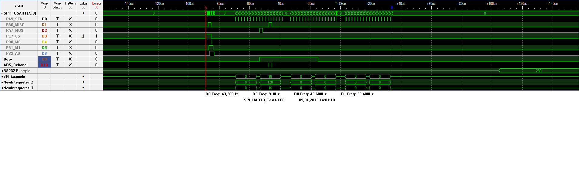

i have a problem  interfacing an ADS8361 with a 32-Bit-Microcontroller. I am using an STM32F4 eval-Bord.
I want to use  mode IV, i followed an example, what i found in your website. I use the logic analyser (Logicport), and i couldnt see till now the same results, what i have seen on the example. Did anyone do this befor?

  • Hi Rachid,
