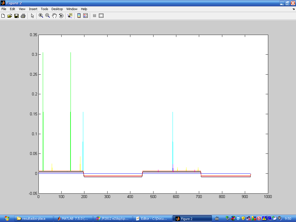

  • Hi Tony, thank you for your response.
    I have some glitches in the signal, in the following figure you will see the problem.
    I really apreciate your help.
  • Hi Oscar,
    Is the data that you are you reading back from the channels that are powered down or on the adjacent channels which are powered up?
    The powered down channels should be reading back as all zeroes. The adjacent channels should not be affected by anything that is powered down. Glitches should not happen unless there is noise in the system (possibly on the SPI interface lines) or an invalid read back of data. Have you looked at your SPI interface to make sure that there are no glitching that is occurring.
