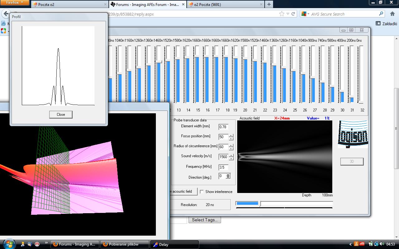

I am working with LM96570 for portable ultra sound system design.By reading the data sheet i got the idea about how to program the delay values and dalay patterns.But I am unable get the what delay values and what delay patterns to be programmed.Please give me idea about the calculation of delay values.

The delays at T/R is used for steering and focusing the acoustic beam. This delays depend on mechanical dimensions of a single piezotransducer, number of transducers involved in acoustic wave excitation, shape of a probe (linear array, curved array), required direction and focal point of the ultrasound wave. Generaly, it is required that the signal acoustic signal traveling from every single transducer should arrive at the same time to the desired point. Some time ago I have developed a simple software for calculating the delays and visualizing the acoustic beam. You can download it from here:

Sir,I am using app which you suggested for delay calculations.Can you provide the documentation of that app ,which can give details about formulae used.
And even i changed the direction the delay values are not changing,my doubt is the delay values are constant for all directions for constant depth,frequency .

Hi Chandu,
For convex transducer the directional steering is not implemented in the software. It only works with linear probe.Change the Radio Button into LINEAR in "Probe selection" groupbox. The delays are calculated using the rule that the acoustic wave from every element should arrive at the same time to the desired focal point.
I dont't have the documentation for this application because I've wrote it for my own only use.

i have gone through the applicaction software for delay calculation meant for a linear array probe.curently,i am doing an ultrasound project using a curvillinear probe. it would be really appreciated if u can help me in calculating the delay values for a curvilinear probe.
regards,prasad
Hello Prasad,
I understand you use the software I have developed. If yes, then all you need is to click the relevant RadioButton on "Probe selection" Group Box. There are two possible selections: Linear and Convex. Convex means curvilinear.
Mariusz
