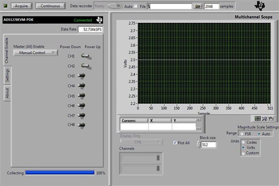

    More updates. I am currently able to get a gain through the differential amplifier on the board. I changed the buffer amplifier on channel 2 and 3 to get a gain of 10 each. I am using an other external ths 4520 of gain 10 to get a total gain of 100. It is avalable across the channel input. But, my current problem is, ADC pro is not detecting any signal in any channel. It responds once in a while and gives a perfect output, but most of the time a perfectly 0 output not even an noise? What could be the trouble.?? Hot to trouble shoot???
    I was using ADS 1278 for a while. Everything was working fine and now what ever be the input to any of the channel I was getting this
    For more information, I am getting my input voltage with out any loss through the amplifiers till the input of the ADC chip. I have changed the gain of channel 2 and channel 3 buffer amplifiers to gain 10 and it also working fine when I checked at the our put of the amplifier. If you have any idea to trouble shoot please let me know.

    What OS are you using? Have you changed any of the jumpers/switches/configuration from the default settings (as shown in user guide)?  Did you power off or unplug the power to the motherboard without closing the software?
  • I am using windows 7.  In my knowledge I am keeping all the switches on position except I took away JP3 away to make my transistors working. I am slightly confused on some description on the manual. They have written J3 is the input buffers power down. But its JP3 which is input buffers power down when short and when open its powered up. J3 is the jumper through which we feed the input right? And its JP2 and JP1 is responsible for FSR and FSX not J1 and J2 right?
    As per the manual I have keprt S1 and s2 off. S6 selected on FS, JP2 on FSR, S3 on internal clock and the channels i used to keep changing from buffer to non buffer. Is there any way I could analyse the output from the DOUT lines pin J2, because, I am pretty sure there is ample amount of input (minimum I given is 73 mv) on the channel input of the chip when I checked with my volt meter. If I could check the output in the same manner, I could make sure its something in the interface.
    If you need any more information please let me know.
