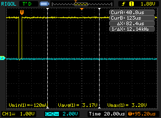

I'm trying to communicate a stellaris launchpad to an ads1282 but i don't get data from the converter.
CLK=4.096MHz    OK
Vref positive=2.5V OK
Vref negative=-2.5V OK
AVDD=2.5V OK
AVSS=-2.5V OK
I have a electrolitic capacitor connected to the bypass line
PWD and RESET to 3.3V
Input signal=sin wave 1Vpp @ 1Hz
 a 10nF ceramic capacitor connected to Capn y Capp, each line with a 75kohms to -2.5V and 2.5V (geophone application in the datasheet)

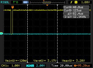

Fig. 1 DRDY (yellow signal) and DOUT (blue signal)

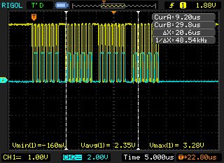

Fig. 1 SCLK (yellow signal) and DIN(blue signal)
Could the SPI interface of the converter be damaged?
  • If you try to read anything and it doesn't work try to send SDATAC command firts and then read/write other things. I had long battle with ADS131E04 (either a SPI device) and that was the reason. Very poorly described on right-top of page 34 of your ADC datasheet.

    Thank you for your answer. It was very helpful. I read data by command instead of continuous and i get data from the converter. So, the SPI interface is working correctly.
    After that, I checked the configuration of the SSI module and I saw that the frame format it was the motorola mode 2 (polarity=1 phase=0):
    SSIConfigSetExpClk(SSI0_BASE, SysCtlClockGet(), SSI_FRF_MOTO_MODE_2, SSI_MODE_MASTER, 1000000, 8);
    I changed the format to Motorola mode 0 (polarity=0 and phase=0) and the problem was solved
    SSIConfigSetExpClk(SSI0_BASE, SysCtlClockGet(), SSI_FRF_MOTO_MODE_0, SSI_MODE_MASTER, 1000000, 8);
