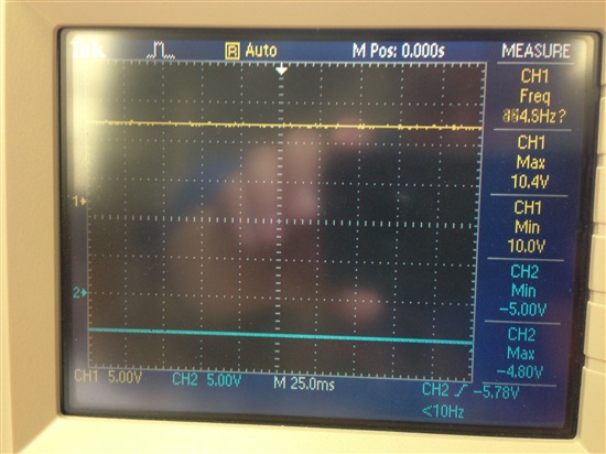

These scope traces have the output updated at about a 5kHz rate and the SPI clock is at 40MHz. Here is a picture of the output with a odd increment:

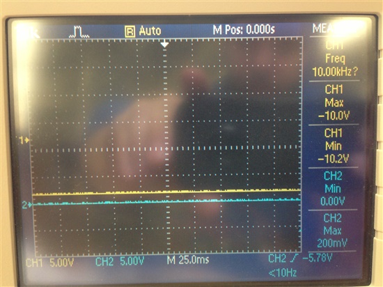

With an even increment and what is expected:

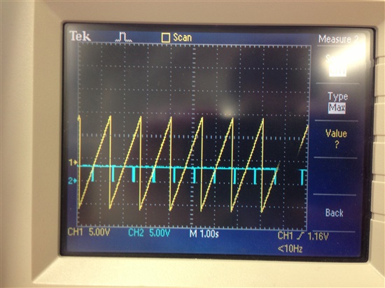

    Sequentially writing even or odd values to the DAC should make no difference on the behavior of the output. Try to get a closer shot of whats happening across the time domain, maybe one period or a half period of the sawtooth waveform so we can actually see what's happening. It looks like theres some aliasing happening with your scope on the first shot.

    I am not sure what aliasing would have to be doing with it. I would expect it to be aliasing if I wasn’t able to see while setting a break point and not actually running the microcontroller in real-time. It seems like a very strange behavior that is going on. Which I am unsure why the DAC would be behaving in this way. The value to the DAC should be able to be increment by 1 and going through the 65535 combinations of the possible values.
    I zoomed in on the oscilloscope to basically see when the outputs are being changed. For some reason the voltage is going to the upper most rail of the output op amps. Sorry the quality of the picture. I wasn’t able to remove the glare.

  • Thank you Bryan! For some reason I finally got access. Here is the attachment of the oscilloscope result. The transitions on voltage would be when values are being sent to the DAC.
