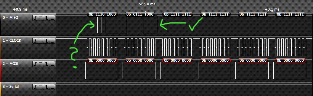

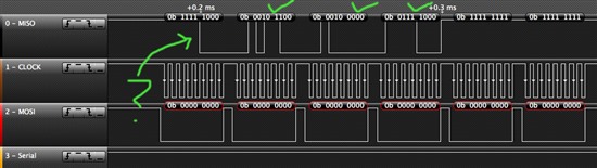

Dear Community,
I already managed to measure voltages correctly and setup the SPI communication between the ADS 1216 and ATMega16. However, if I send the read command (&B00000001), I receive four instead of three bytes from the ADC. The first one is always 248 if the mux register (01111000) is written and read within one reading cycle with the data read statement (see code). If the mux register is set with 01111000 only once before the reading loop, I get no response for the read command for the entries in the mux register and hence no reasonable ADC data. CS is tied low all the time, Dsync is always high.
I would really appreciate if somehone has any hints why I get more bytes than expected and why the second code doesn't work, although it's pretty similiar to the first one. Many thanks in advance!!!
Constantin
Here's the result of the mux register read command (1st byte strange, 2nd correct): mux register written and read before every data read command
And the answer after the read command (again, 1st byte nonsense, rest is fine): mux register written and read before every data read command

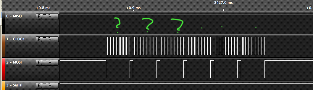

If the mux register is set only once before reading the data, even the mux register fails to be read. Write to Mux: Mux-Register, 1 Byte, 01111000
No response??

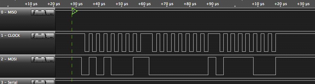

  • Hi Constantin,
    Welcome to the forum! The thing I noticed in your logic shots is you are idling SCLK high.  For this mode of operation the POL pin must be set high.  Also the data should be valid on the rising edge of the clock and transition data on the falling for this mode.  From the shots it appears the data is changing on the wrong clock edge, and from your code it appears that you are pulling the POL pin low.  See the timing diagram on page 8 of the datasheet.  Until the timing is correct it is hard to tell what is really going on and how the part is interpreting the communication.
    Bob B
  • Many Thanks, Bob!!!  With the right POL-Setting everything works now as it should be! Great. Kind Regards, Constantin
