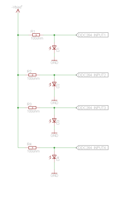

DDC264 Photodiode input with negative Vbias
Other Parts Discussed in Thread: DDC264
I currently testing the DDC264 to measure the dark current of  few photodiodes (see the schematic above).
The photodiodes are biased with -4V  from a single supply. Is there a problem with the my schematic since the measurement I have collected seem to be
gibberish.
Thank you
