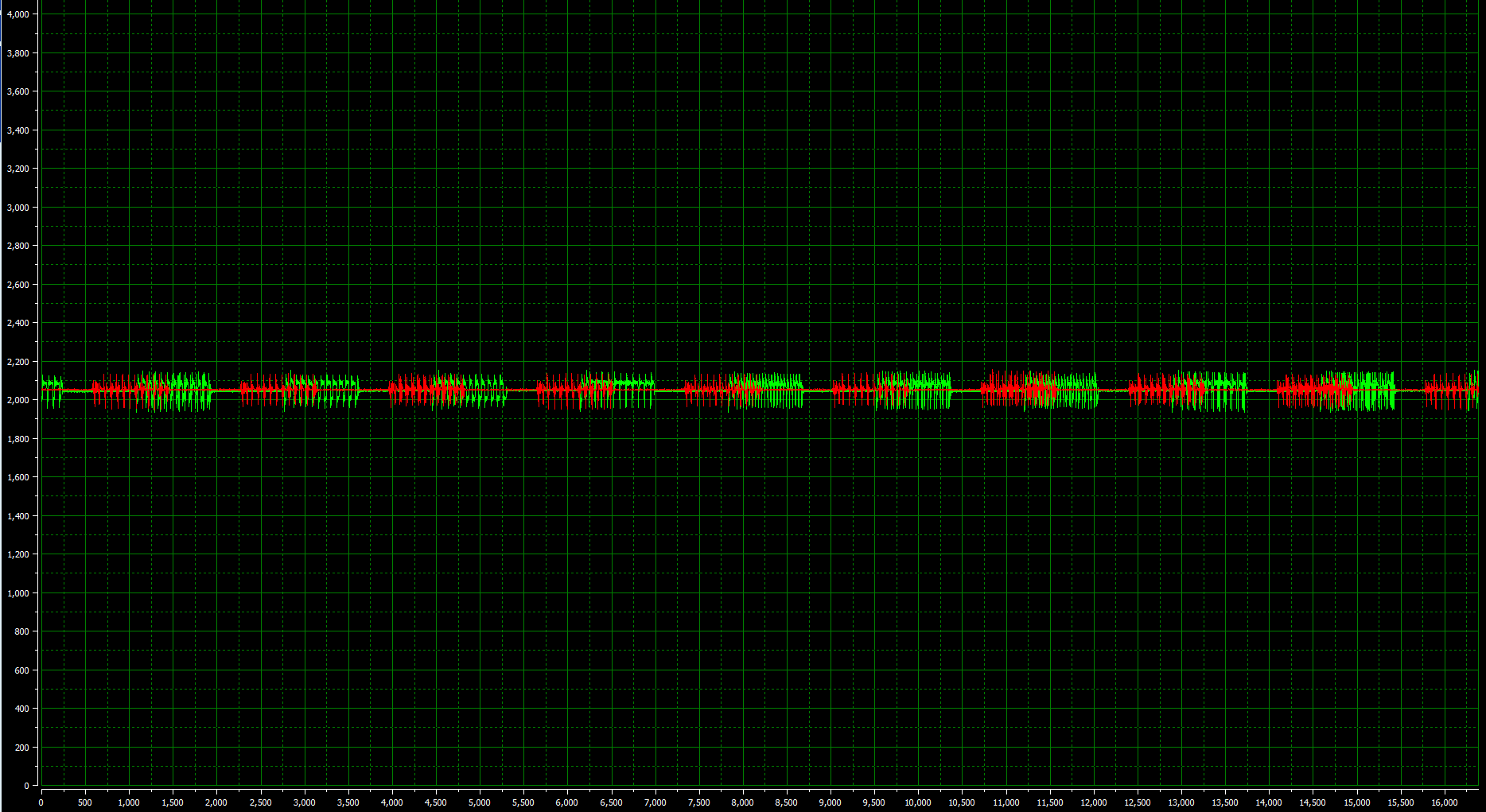

    The issue remains. Here is a screenshot to show you what I am seeing:
    The two channels (I in red, Q in green) both have data or no data (flat) at the same time when transmitted. When probing the I and Q signals just before entering the ADC, the green and red pulses you see in the image above are lined up. However, this is not the case in the WaveVision 5 GUI; from viewing in WaveVision 5, it seems that "n" I samples are read, then "n" Q samples. I have confirmed this by labeling the individual packets and observing that the last packet observable on the right side of the window on Channel I is the same as the first packet observable on the left side of the window on Channel Q. All packets are the same length. You'll notice that if you observe the partial last red packet and the partial first green packet on the image above... they add up to be a full packet.
    The new FPGA image did not seem to fix this problem (this is exactly the problem I was observing before). Is there a step I missed? Does this differ from the behavior you are seeing? Is there something I might be doing incorrectly in WaveVision 5 (I am using I and Q non-dual-edge-sampling, 16K samples per channel, single-capture mode instead of continuous)? I really need to have this fixed soon.

  • Hello Jim,
    The problem persists with 4K or 8K samples per I/Q channel. The screenshot exhibits identical behavior (I and Q not lined up in WaveVision 5, but lined up on transmission and right before entering ADC on oscilloscope).

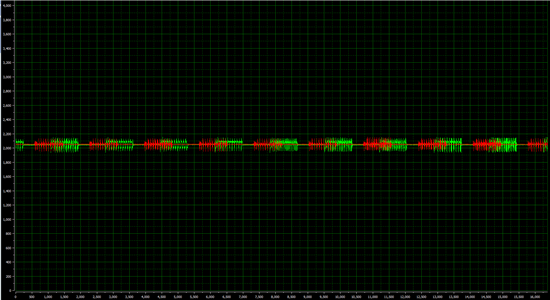

  • Hello Jim,
    Thank you for the second observant look at my post. Lesson learned: always describe exactly what you did (and do exactly as told) when trying to remotely debug hardware.
    Your solution works:
    This solution also cleared up a problem I was having with accessing 32K samples per channel.
