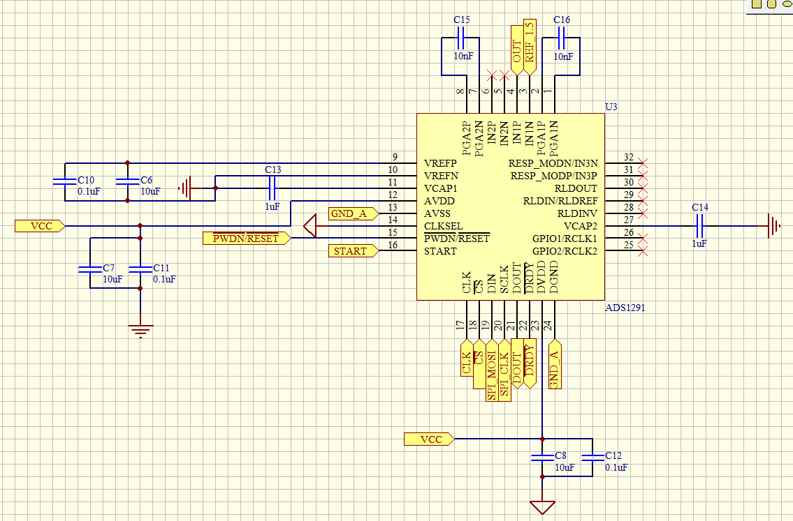

is my circuit of ADS1291 right?
Other Parts Discussed in Thread: ADS1291, MSP430F5522, MSP430F5529
hello everyone. I have a problem about ADS1291. Here is my circuit plot
I use the Single-end Input. The input of IN1P is the ouput of an instrument amplifer and the common voltage is 1.5V
and i use the same VCC which is 3V for AVDD and DVDD.
and the same GND for AVSS and DGND.
and i connect the rest pins to a msp430F5522.
But somehow i can't read the correct output .
 i already check the analog amplifer is fine so the input of INIP is fine.
so i am not sure is there something wrong with my ADS1291 circuit or my MSP430 Firmware.
anyone please help me check out my ADS1291 Circuit?
thanks a lot
  • are you using this chip for ECG application? why you need an amplifier? first you can configure ADS1291 in test mode, and check if you can get 1Hz from your host.
    second you can use scope check PGA1p or PGA1n, see if there are any signal you expect.
    the most important is to setup the registers correct.  what are values of your registers?

  • HI . David.
    i am using this chip for EEG application. That's why i need an amplifier before the ADS1291.
    I don't know what's PGA1P and PGA1N for?
    And i already test this circuit in bread board with Msp430 development Board, and it can work.
    but after the PCB LAYOUT is finished. I test  my PCB (instrument amp and ADS1291)  with MSP430F5522 on another PCB  ,something goes wrong.  I using the external CLK 2.048MHZ for ADS1291 ,and 4MHZ or 4.096MHZ for SPI CLK (i am not sure).  I found that i can't setup the right register .

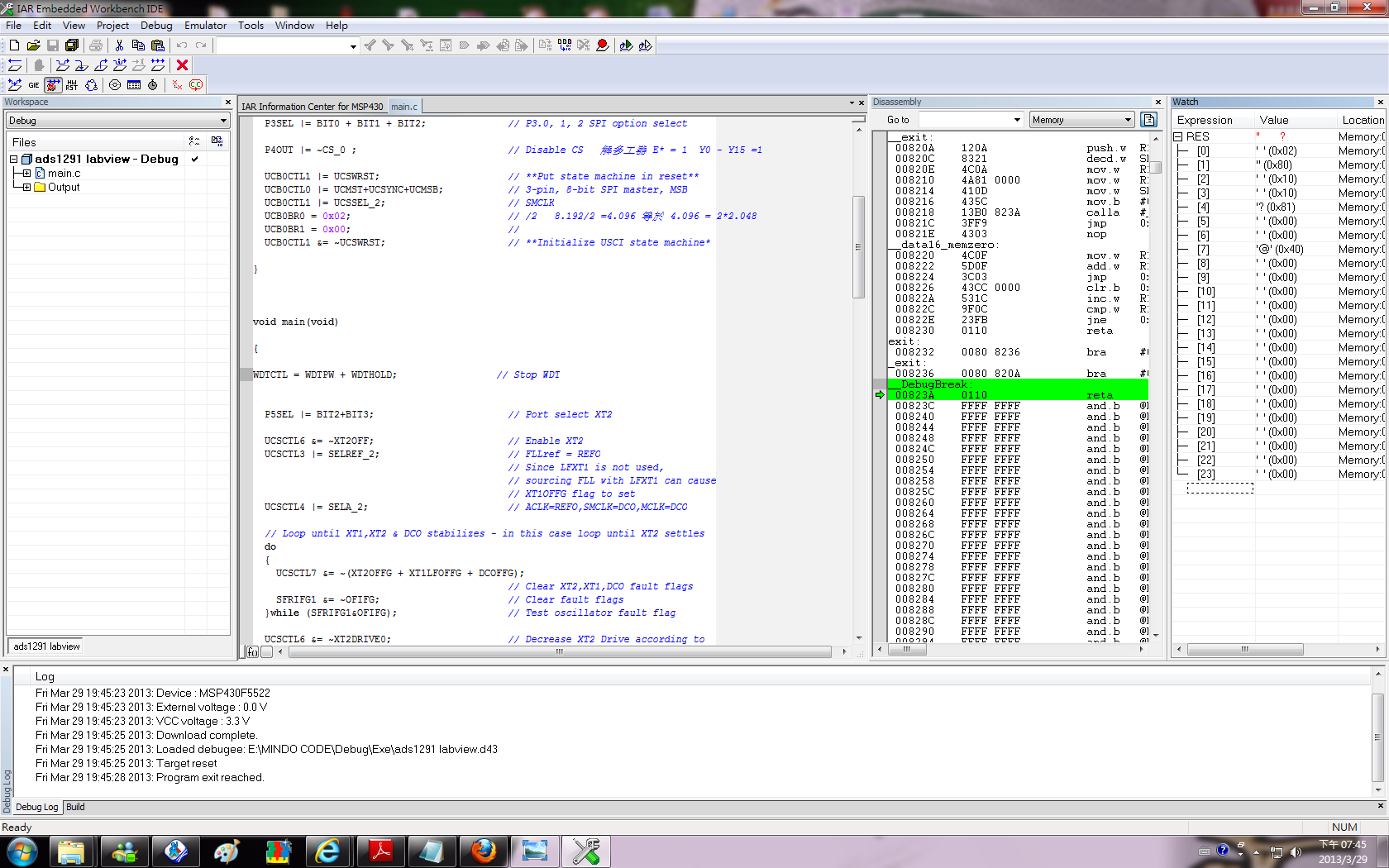

    Here is my Code and my result about write and read ADS1291 registers.

    Thanks for help.
  • it will take me some time to fulling understand you code.
    here is my question, can you use SPI communicate to ADS1291, can you write the register and read them back. if the answer is yes. then we focus on the value of the register.
    if you couldn't talk to 1291, then we will focus a different issue.
  • HI David. thank you for help.
    i can talk to ADS1291 (on bread board)  with MSP430 development board  . can write and read ADS1291 registers correctly.
    but now. i can't talk to ADS1291 (PCB board with instrument amp on ) with MSP430F5522 on another PCB board. can't write and read ADS1291 registers correctly.
    should i sent you my Firmware about  using MSP development board and using MSP430F5522 on PCB board?
    i think the most different place is ADS1291 CLK and SPI CLK
