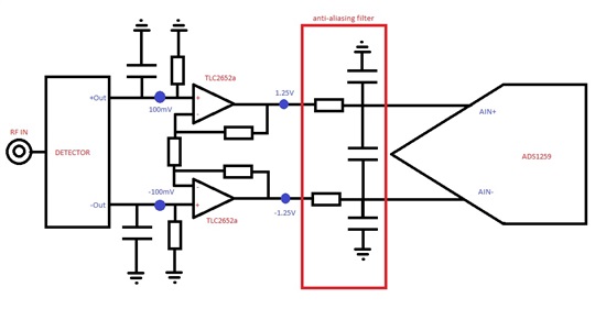

I attached a block diagram of a system I'm trying to build and I have few questions about ADS1259 .

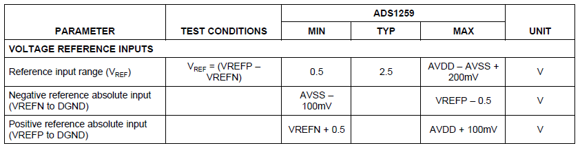

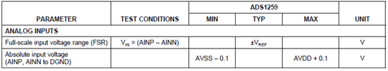

1) What is the max input voltage on ADS1259 analog input pins if I'm using +-2.5V supply and a external reference REF5025 and how to connect it on the VREFP and VREFN pins? VREFP=REF5025 output and VREFN=AVSS ?
2) Anti-aliasing filter, how to calculate R and C of the filter , FD=1/(2*pi*R*C)?  What corner frequency should my filter have if the output of DETECTOR is DC voltage?
3) In the datasheet of TLC2652a stand that Equivalent input noise voltage Vn(f=10Hz)=140nV/sqrt(Hz) and if i have gain=3 the output noise is 420nV/sqrt(Hz), and the noise of ADS1259 (Table1 in datasheet) @ 1200SPS = 2.3uVRMS and if I use 10Hz band filter that means noise after filter is =sqrt(1.57*BW)*420n=1.66uVRMS ? But i saw that the corner frequency of filter must be greater or equal FD for the 1.2kHz NOISE=18uVRMS , or I'm wrong ? How is this connected  if you can give me a hint.

    1) The max and min analog input voltage on either input is limited by the supply voltages. Typically, you don't want the input signals to exceed the supply rails or you will turn on ESD diodes between the inputs and supplies. Additionally, the differential voltage between AINP and AINN (the positive and negative analog inputs) should not be greater than the reference voltage, otherwise the digital output code will saturate at full-scale.
    The reference inputs behave similarly with absolute and differential limits. You can connect VREFN to AVSS and VREFP to AVSS + 2.5V. To do this though, the REF5025 needs to be referenced (grounded) to AVSS.
    2) I don't have the block diagram to see what you're referencing, however, if the input signal is a DC voltage you can use a low cutoff frequency. Just keep in mind that step changes (during power-up for example) will take a longer time to settle and you may have some invalid conversions results while the ADC is sampling the charging capacitor voltages.
    3) If I understand you correctly, you are calculating the RMS noise contribution of the op amp after the RC filter. You are mostly correct in your calculation, however, you need to multiply the noise density by the bandwidth squared:  420nVrms/Sqrt(Hz) * [1.57*10Hz]^2 = 103uVrms.
    This noise value will be added to the intrinsic noise of the data converter (2.3uVrms @ 1.2kSPS).  Adding non-correlated noise sources: sqrt(103uVrms^2 + 2.3uVrms^2)  = 103.55uVrms.
    You can see that the op amp noise dominates. The TLC2652 is a older device with high noise. You can find newer op amps with much lower noise, closer to 1nV/sqrt(Hz) which will give you better performance, especially when used with a 24-bit data converter. You will want the op amp noise contribution to be comparable to the ADC's intrinsic noise or much less to get the full performance of the ADC, otherwise you will not benefit from a 24-bit data converter.
    If you can share the block diagram and any op amp requirements you have for your application, I could help recommend a lower noise op amp.

    ->You can connect VREFN to AVSS and VREFP to AVSS + 2.5V
    The pin VREFP=0V?

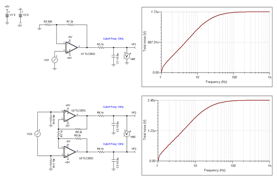

    I'm sorry, I was off on my units in my noise calculation yesterday. Your calculation is correct, you get 1.66uVrms on the output of the TLC2652 with a gain of 3. In a two op amp instrumenation amplifier configuration (like you have), the noise is further increased by sqrt(2) becuase the noise of each amplifer adds in a non-correlated way.
    I simulated the noise this time to double check that I'm not misleading you.
    4186.TLC2652 CKT.TSC

    The pin VREFP=0V?
    Yes! See the ADS1259EVM schematic on page 39 of this document: http://www.ti.com/lit/ug/sbau163a/sbau163a.pdf. The REF5025 is connected in this way.

    If your cutoff frequency is below the ADC datarate your filter will reduce the noise even further. You don't need to worry as much about a maximum resistor value as the total noise will be limited by the size of the capacitor now. (kT/C noise)
    The settling time is directly related to the RC filter's time constant.

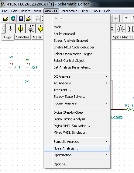

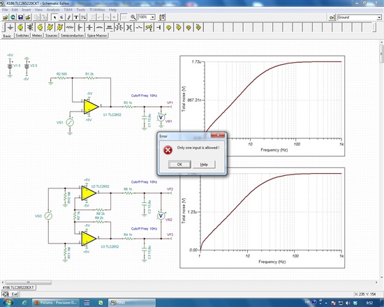

    How to start simulations in TINA after I open the file that you attached and change some values?
    David.

    From the "Analysis" menu you can run DC sweeps (Called "DC Transfer Characteristic..." in the DC Analysis sub-menu), Frequency Sweeps (Called "AC Transfer Characteristic..." in the AC Analysis sub-menu), or Noise Analysis (highlighted below).

  • Hi Chris
    When I choose Noise Analysis a pop-up error appears
    David.

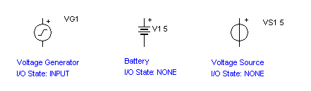

  • Hi David,
    There are three types of voltage inputs in TINA:
    In your circuit there are two "Voltage Generators" and both default to the "INPUT" I/O state. Therefore, TINA does not know which input to use for the noise analysis.
    You will have to test these circuits one at a time (either split them into two files or change the I/O State of one of the voltage generators to "NONE"). I had put them into one file for comparison, but I did the noise analysis separately.
