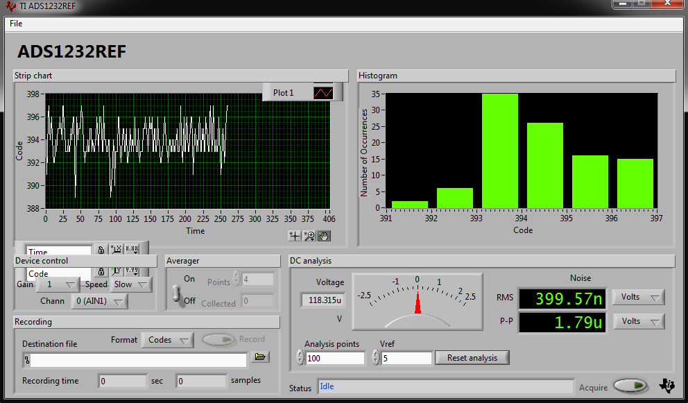

On ADS1232REF GUI version 1.4.0, when selecting Visible Items->Scale Legend the window appears behind the Device Control window, NOT allowing selection of the Code settings.
The same issue appears when selecting Visible Items->Plot Legend the window appears behind the Strip Chart window, NOT allowing selection of the above Plot.
Please view attached image ADS1232REF.Version1.4.0.png showing the window blocking issue.
