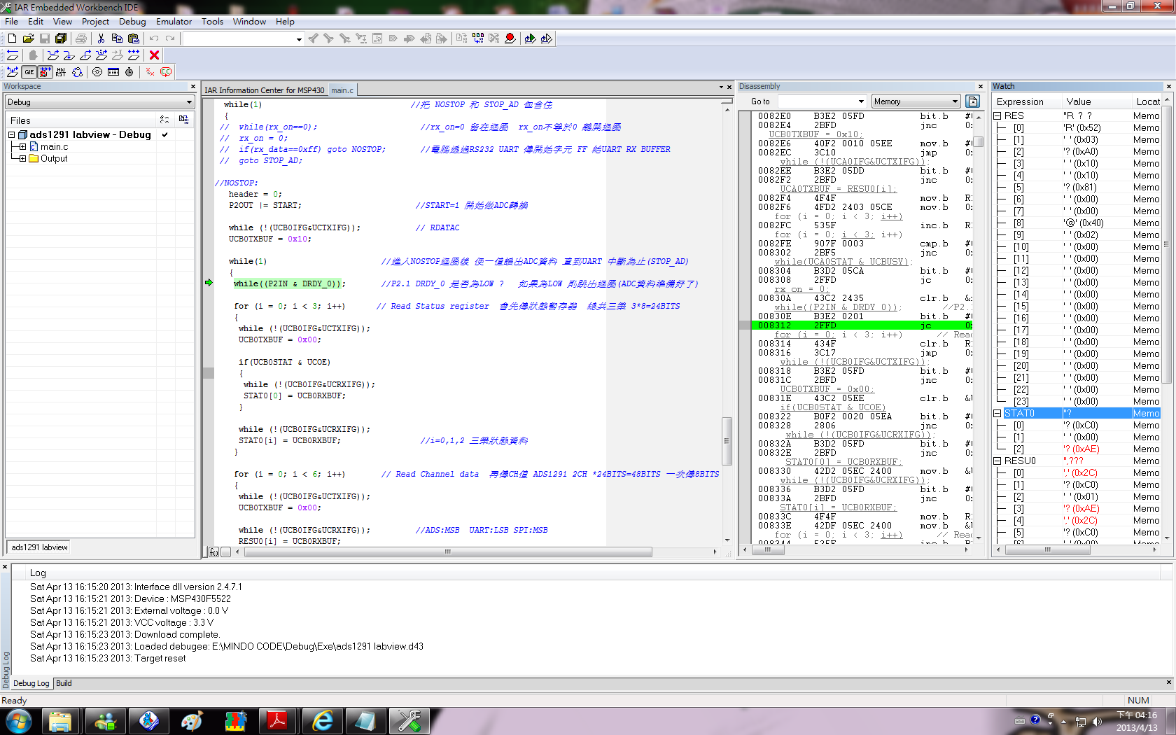

hello everyone.
i  have problem receiving data from ADS1291.
because of the data i get from ADS1291 is weird.  so i check the first 24 bits which are status register.
i save the Status registers in STAT[0] to STAT[2]
the status register supposed to be 0XC0  0X00 0X00
but i got wrong data.
and save the output two channel data in RESU0[0] to RESU0[5]
but i alraedy power down CH2. but still get reading from RESU0[3] to RESU0[5]
anyone can help me?

  • and i also find out.
    the output 2 channal data  24*2 bits    RESU0[0]  to RESU0[5]   and STAT[2]  is apeer repeatedly.
    STAT[2]     0XAE
    RESU0[0]  0X2C
    RESU0[1]  0XC0
    RESU0[2]  0X01
    RESU0[3]  0XAE
    RESU0[4]  0X2C
    RESU0[5]  0XC0
    So why this happened?
    something goes wrong with my SPI Clock?
    or something goes wrong with my receiving Firmware?
    thanks a lot
  • Why do you create new threads while there are several others about the same issue all created by you? Ex: http://e2e.ti.com/support/data_converters/precision_data_converters/f/73/p/258230/903420.aspx#903420
    You need to write abstraction layer. Write function  char ADS1291_READ_REGISTER(char addr). Apply timing requirements specified in datasheet. Check clocks and power. Study datasheet. Study datasheet again. If all fails get EVM and study EVM.
  • HI MankejKucia.
    i am not quite understand " You need to write abstraction layer. Write function  char ADS1291_READ_REGISTER(char addr)"
    what you mean?
    can you tell more detail?
    thanks a lot
  • I meant that your code is a mess. Did not want to tell this directly...
    If you want your application to work you need to apply basic engineering rules: simple, clean & compact.
    In datasheet you can find info on initialization. The registers need few clock cycles to get default values. Maybe this is the problem.
    Maciej
  • hello MaciejKucia
    it's totally fine to tell me that my code is a mess.
    and i really not good at coding....

  • Dear Maciej
    as the Picture you can see.
    I save the ADS1291 Registers in RES
    RES[0] = ID register = 0X52
    RES[1] = CONFIG1 = 0X03
    RES[2] = CONFIG2 = 0XA0
    RES[3] = Lead-Off Control Register = 0X10
    RES[4] = CH1 =0X10
    RES[5] = CH2 =0X81
    RES[6] = RLD_SENS = 0X00
    RES[7] = LOFF_SENS= 0X00
    RES[8] = LOFF_STAT = 0X40
    RES[9] = RESP1 = 0X02
    so i can read/write the ADS1291 correctly
    thank you Maciej
