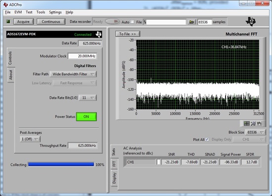

I have the ADS1672EVM-PDK and I am trying to verify the performance of the ADS1672, specifically the noise floor.
 With the inputs shorted together and biased at 2.5V from the onboard Vref through R53 and R54 I can’t get the noise floor specified in the data sheet.
Sample size 524288
Block size 524288
Window Blackman-Harris
The spectral noise is between -120 and -140 dB relative to full scale.
Using the EVM with the MMB0 how can I verify the performance of the ADS1672?
