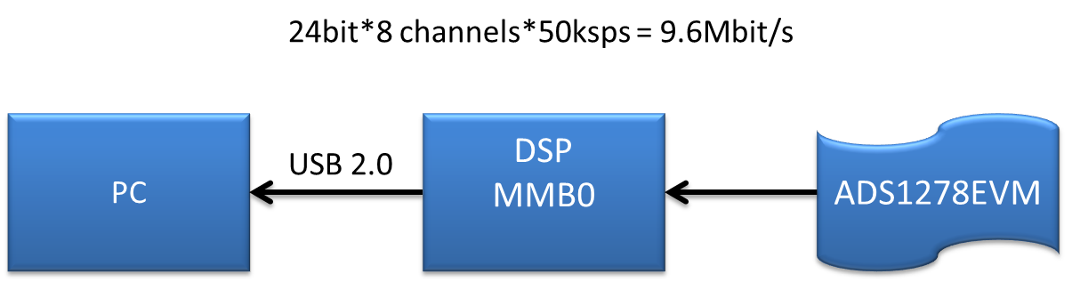

I would like to use the ADS1278EVM to get data from 8 different channels to a DSP. In this case, the DSP might be the motherboard MMB0 which comes with the DSP-board.
The data should be moved to the DSP by using SPI. Furthermore the DSP has to move the data to a PC by USB 2.0.
Is it possible to use Code Composer to program the ADS1278EVM-PDK? I couldn't find a hint on the product page.
Furthermore, can i use the JTAG-interface on the MMB0 to program the DSP on the board individually? If so, is it possible to use the onboard USB interface for my issue?

    J8 on the MMB0 is a JTAG header (see MMB0 schematic @ ftp://ftp.ti.com/pub/data_acquisition/ADCPro/Support/MMB0_Sch_RevD.PDF).  It is not populated, so you will need to install the header.  But you can use this to program the DSP and/or debug your program using CCS.
    In terms of the USB, keep in mind the USB 2.0 is only Full Speed capable, not High Speed - just in case you are counting on the faster data transfer.

    Thank you very much for your quick response. Since I got about 10Mbit/s of data full speed should work just fine.
    Is there a chance to use the SPI pins for a different DSP? For example i already have the EVM for the TMS320F280 which might also be considered for the data acquisition.

    The ADS1278EVM is just manually plugged onto the MMB0 motherboard - they can be separated to use the ADS1278EVM with another circuit/processor/your system etc.  As long as you follow the ADS1278 timing specs, you can use another SPI to talk to the EVM.  Note if you are trying to use it on the MMB0 (just for power connections), you may have to remove the bottom connector to prevent contention of the SPI from your device and the C5507/9 on the MMB0.  The schematic for the EVM is available in the user guide @ www.ti.com
