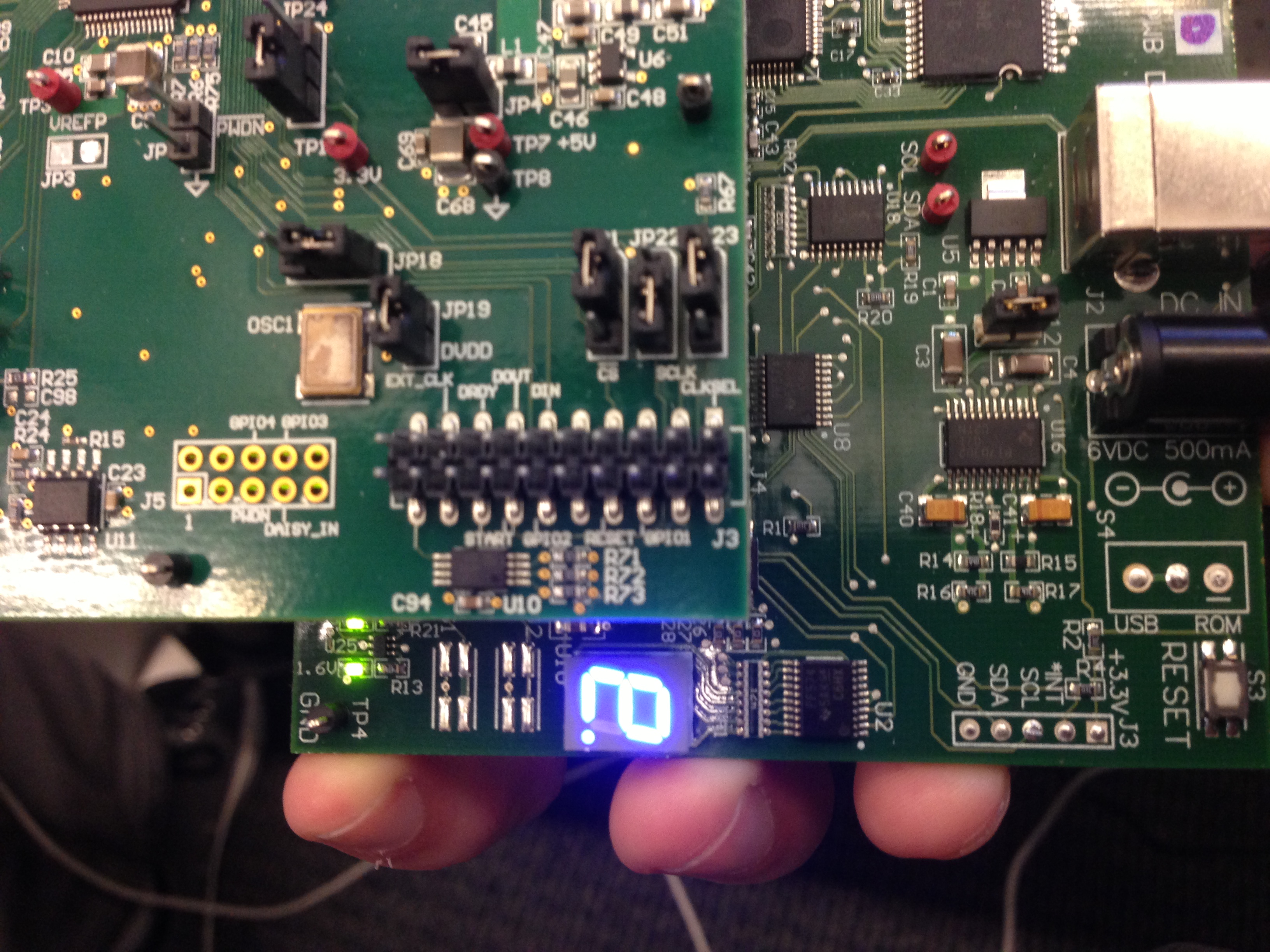

    And I met another problem, I was wondering maybe you can help me. From yesterday on, my platform can't read registers anymore, it takes more than 20 minutes to read registers but all registers are 0, and the 7-segment display on the platform doesn't work as usual.
    I don't know what's the problem, I re-installed the software but it doesn't  work. I hope you can help me.

  • Hi Yun!
    I'm glad you are seeing success now with the generated test signals.
    I saw this response about the register problems on your other post, here: http://e2e.ti.com/support/data_converters/precision_data_converters/f/73/t/262885.aspx.
    It was perfectly fine to start a new thread with this question, but please refrain from duplicating your posts on more than one thread.
    I will gladly work with you on your new thread and close this one. :)
