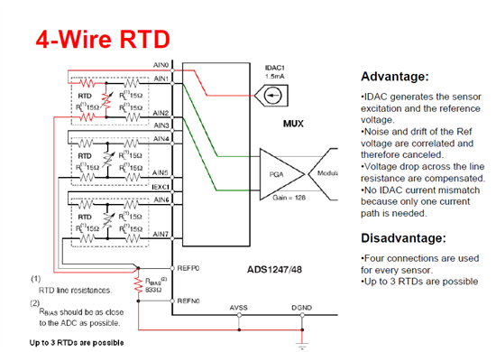

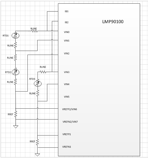

can i use 3 RTD in 4 wire configuration connected in series with same current source and same Rref as only one RTD voltage is sampled at a time. if this not possible then how can i connect 3 RTD in 4 wire configuration with a single LMP90100.
please suggest me any application note wich can describe SPI communication in contrast to this IC.

    All 4 wires of 3 RTD would be a difficult connection. See following schematic where you could use the 4 wire RTD's as 2 wire RTD's.
    Also consider the ADS1248

  • Dear Jason,
    I have the same question as Varun and did'nt quite get the answer. Is it possible to use a single Rref alone across only  VREFP2 - VREFN2 ? For example you have used only a single Rbias across REFP0 and REFN0 to measure from all the three RTD's on the ADS1248. Can the same configuration not be used with lmp90100.

  • Hi Satish,
    The limiter is the number of current sources you have. The LMP90100 has 2 current sources. If you use the topology shown in Figure 80 in the datasheet you can use 2 RTDs. The first RTD would use IB1, VIN0, VIN1, VREFP2, and VREFN2. The second RTD could use IB2, VIN2, VIN3, VREFP1, and VREFN1. It would be harder to use the same resistor across one set of VREF pin, because both current sources turn on at the same time, so you would have the currents of both RTDs going through RREF at the same time.

  • Thanks Mike.
    Can I also connect two RTDs(both 2 wire and 3 wire RTDs) with the topology shown in Figure 78, which uses two current source per RTD.
    Also, can I omit the compensation resistance RCOMP without much impact on the accuracy ?
    Sathish
  • Hi Sathish,
    If you are using the topology in Figure 78 you can only connect one RTD.  You would need another two current sources to be able to connect another RTD.  Another possibility is to use a device to switch to connect the current sources to one or the other of the RTDs, if you want to use two of them in the Figure 78 topology.
    Yes, you can leave RCOMP out.  It is used to set the Vin to be0V at any temperature.
