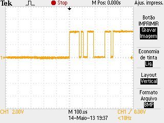

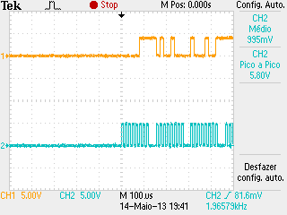

  • RKI,
    Can you be a little more precise on what your actual problem is?  Can you send me your schematic?  Have you verified your communication with an oscilloscope?  Can you send me some scope pictures?
    Bob B

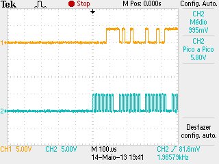

  • thanks bob,
    Now I'm in trouble Dout, is very unstable, values ​​are varying widely. how can I stabilize?
  • Hi RKI,
    If you are using a prototyping system you will have many issues with noise causing instability.  To get a high level of performance you need to have a PCB with a solid ground plane around the ADS1232 and the analog portion.  You need to be very careful with routing so that the analog and digital portions are separate from each other.  It is very easy for digital signal noise to transfer to the analog portion.  Any wiring external to the ADS1232 (such as load cell wires) can act as an antenna and pick up power line noise as well as RFI/EMI.  These wires should be shielded and the shield properly grounded (earth.)
    Bob B
