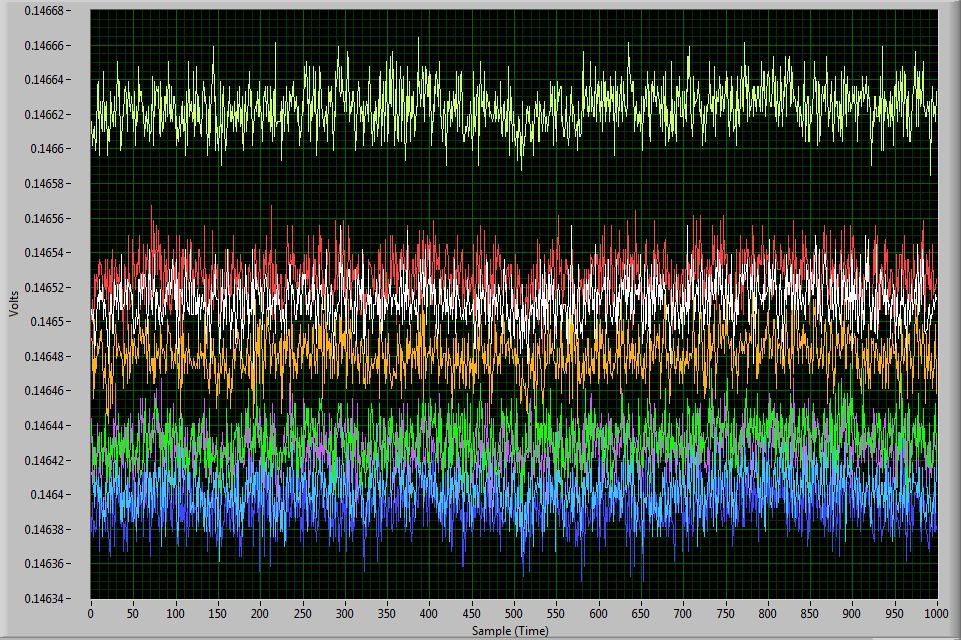

    Using the ADS131E08EVM-PDK and software with default settings and changing all input channels to Temp Sensor, the below data was captured to agree with the specs.  Perhaps there is a factor of 10 off in the calculation.  This would at least get you in the neighborhood of the data shown.

  • Something sounds off...are you reading the data yourself (external processor) or using the -PDK?
    Attached is the data corresponding to  the graph above (taken using the -PDK).  The last column shows conversion from hex codes to decimal and volts (for your reference).  If you are reading using your own processor, you may want to revisit the data capture to make sure that you are reading data correct.
    Also attached is the register settings for the device...these should be the -PDK defaults with 4V ref and Temp selected as input.

  • Total Embarrassment!
    Following your advice to the letter - a close inspection of the board showed up a solder whisker connecting pin 55 (VCap3) to Pin 56 (AVdd).
    This was holding VCap3 at 5V, whereas, it looks like there must be an internal charge pump - as it sits at about +7V when the whisker is removed.
    My board now reports approx 145mV as the Temperature sensor voltage - in close agreement with your results. (approx 146mV)
