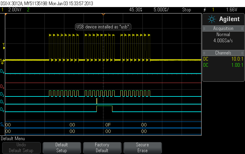

  • HI Bob,
    Yes, CS is always low. DRDY on the other hand remains high. D0, D1, D2, D3 and D4,  are MOSI, MISO, SCK, DRDY and CS respectively.
    Hamid

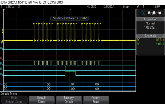

  • Hi Hamid,
    Take another look at the ADS1241 timing diagram on page 6 of the datasheet.  For POL equal to 0, the data must be stable on the falling edge of SCLK.  You need to adjust your controller clock phase for the correct clock edge (changes on rising edge and stable on falling edge.)
    It also looks like the DOUT is either floating or noisy.  Double check and make sure you have solid connections.
    Bob B

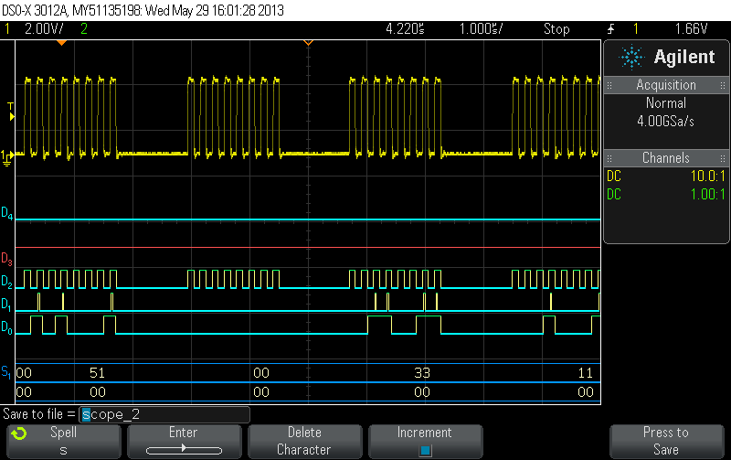

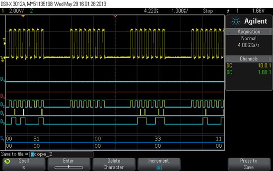

  • Hi Bob,

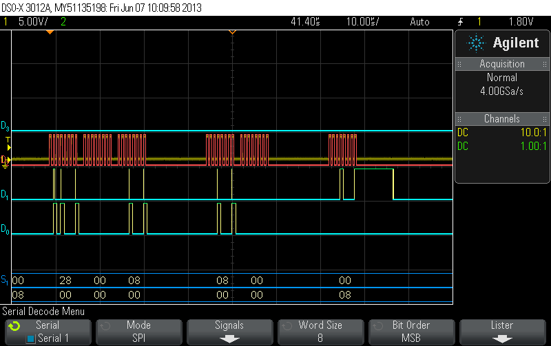

    Thank you for your response. I changed the spi mode and freq. to 1 and 1MHz respectively. The DRDY pin(27) is always high and the chip still does not respond.
    Hamid
  • Hi Hamid,
    Please send me your schematic.  For the device to properly operate you must have the required supplies, you must attach a crystal or supply a clock to pin 3, and the appropriate voltages should be applied to the digital pins. Pins 5, 6 and 7 must be logic high, and the remaining digital pins connected for the desired operation.  If you don't see DRDY (pin 27) toggling most likely one of the previous conditions are not met.
    I would also like to see a new scope shot of the communication to verify it is now correct.
    Bob B

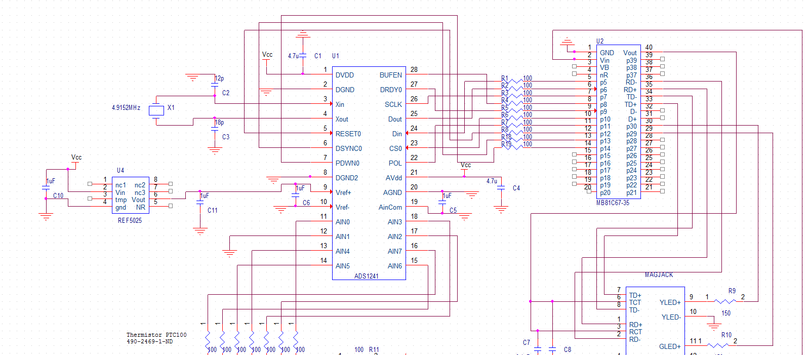

  • Hi Bob,
    Thank you for the follow up. Please see my schematic and the scope shot below. The Analog and digital input voltages are all within the ranges defined in the datasheet.
  • Hi Hamid,
    Have you probed the crystal with an oscilloscope to make sure that it is oscillating and at the correct frequency?  When you checked the voltages, did you check the voltages at the ADS1241 pins or some other place?  Are you absolutely sure you are making a good connection from the ADS1241 AGND and DGND to your power supply ground?
    If you do not see DRDY toggling, then you are most likely having an issue as I detailed before.  Also, if the crystal is not oscillating, nothing on the chip will function.

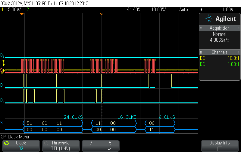

      spib1 = spi.write(0x51);                 //  write to MUX register
    spib2 = spi.write(0x00);                // number of register to be written -1
     spib3 = spi.write(0x44);                // read AIN4
    spib4 = spi.write(0x11);                 //  read to MUX register     wait(50e-6);
     MUXREG = spi.write(0x00);                // number of register to be written -1
     pc.printf("\r\n spib3 = %x spib4 = %x, MUX = %x  \r\n", spib3, spib4, MUXREG);

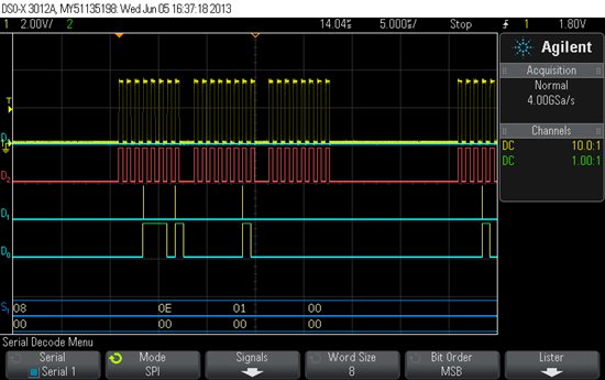

  • Hi Bob,

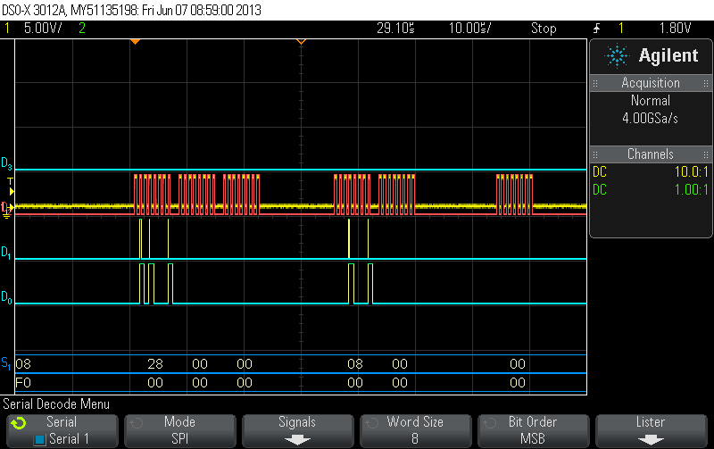

    Please see the following scope shot.    DOR23-DOR0 should contain a count proportional to the input voltage connected to  the given channel. The formula we once discussed is        V = Count * Vref / (2^23-1).
    The most significant byte is always 0 regardless of the input voltage, so that's one indication of not reading correctly. The count we see on all channels when the pin is floating or if there is a voltage there (0.5 - 1.5) remains close to 1000, and  the calculated V is always zero. This is of course when   gain = 1. I changed the delay between RDATA command and reading the 3 bytes to 12 uS without seeing any change in the result.
    The scope data is a bit curious. The numbers I see on the scope serial bus is always half of what we actually transmit on the SPI bus. .
    Kind regards,
    Hamid
  • Hi Hamid,
    I'm not quite sure what you are trying to show me with the scope shot.  You are writing 0 to the MUX register and reading back 0.  I'm more interested to see if you can read back the default values of the registers (or at least write something non-zero and read back.)
    Bob B

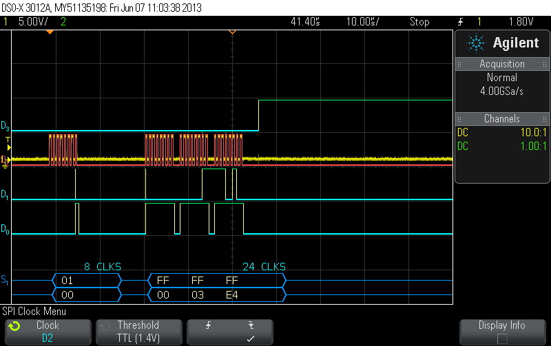

  • Hi Bob,
    I was reading the data register in the pervious shot. Please see the following image.  We are  writing 11 to MUX register here,  and read it back. Again, the numbers shown on the serial bus are half of what I actually send.  0x51 is shown as 28 and so on.
    Hamid
  • Hi Hamid,
    You are writing and reading correctly to the ADS1241.  Your serial protocol analyzer is reading the data on the wrong clock edge (incorrect phase.)
    Bob B

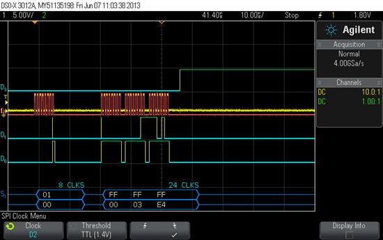

  • Hi Bob,
    Thank you for your feedback. I have corrected the phase in the new image bellow.  The data sheet states that when new data is loaded to the data register DRDY goes low so, I try to read data at that point. The counts I get however are off. I have a 0.7 Volt input hooked up to channel 1. We have written 11, to MUX register, so I should be getting meaningful count if the timing is correct. Do see any timing  issues with the second image?  D3 is connected to DRDY pin and as you see the most significant bit is 0.
    Hamid
  • Hi Hamid,
    The timing looks correct.  Do you have a schematic that I can look at?  What value of reference voltage are you using?
    You are getting 996 codes for what ever value reference you are using.  According to the MUX register setting you are shorting the inputs, so you would expect to see 0 code (+ noise and offset.)  If you have not issued a SELFOCAL, then I've seen shorted inputs as high as 2000 codes of offset, so for shorted inputs you are in the correct range.

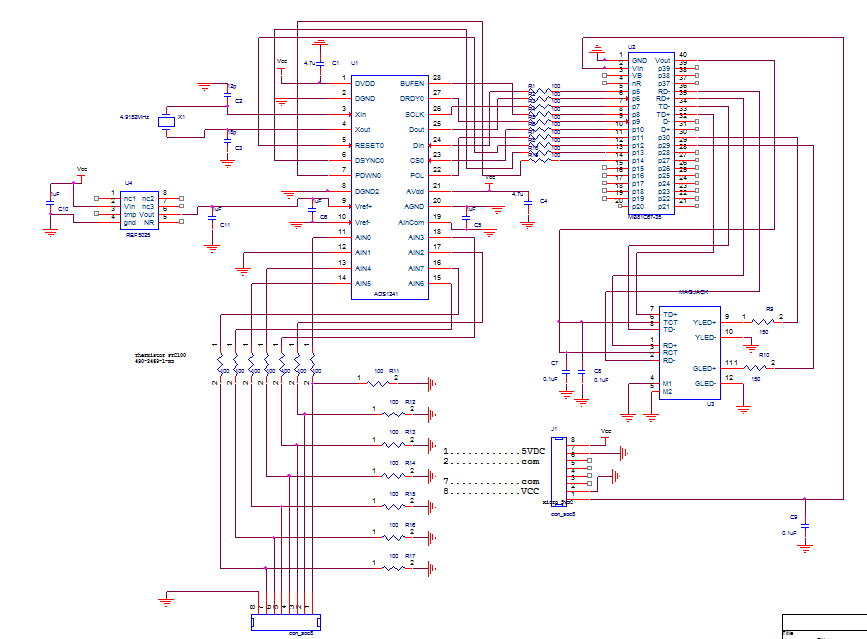

  • Hi Bob,
    Please see the schematic bellow.   I  issue  SELFOCAL at the top of my code, and use a 2.048 V as our reference voltage. Thank you for the point on differential vs. single ended measurement.   We are reading voltage with respect to AINCOM, so now our number looks more reasonable. It seems to me making differential measurement leads to a more solid reading with less drift. I am not sure why but I do get more drift when I read voltages with respect to AINCOM. Do you have any preference between the two? And gain my schematic follows, please feel free to make comments on the circuit.
    Bes regards,
    Hamid
  • Hi Hamid,
    Now that we have the digital portion working we can concentrate on the analog portion.  One thing to keep in mind is the measurement is always a differential measurement no matter if it is connected as a differential input signal or a single ended signal.  What makes the two measurements differ is with respect to range.  With a differential input voltage you can have a + or - measurement swing, whereas the single ended input voltage can only have a + result.  The method used for setting up the MUX for the measurement are the same for both where the AINPOS and the AINNEG must be connected to something.  According to your schematic, you can make a measurement when AINPOS is connected to AIN0, AIN2, AIN3, AIN4, AIN5, AIN6 or AIN7.  AINNEG can be connected to either AIN1 or AINCOM.
    You must make certain that the value used for your calculation matches the actual reference value used.  You stated you used 2.048V but the schematic shows a REF5025 which is a 2.5V reference.
    I'm not sure how low of an impedance your source voltage is, or how stable the voltage is relative to 100 ohm resistor.  The 100 ohm resistor can self heat and change value and can also have drift and be noisy.  You might see more stability if you add a cap from the input (at the pin) to ground of about 10nF.
    Depending on the AVDD supply value, you may see issues if you are using the ADS1241 with the buffer enabled.  You have a restricted input range with the buffer enabled.  It will be better to have the buffer disabled when making single ended measurements.
