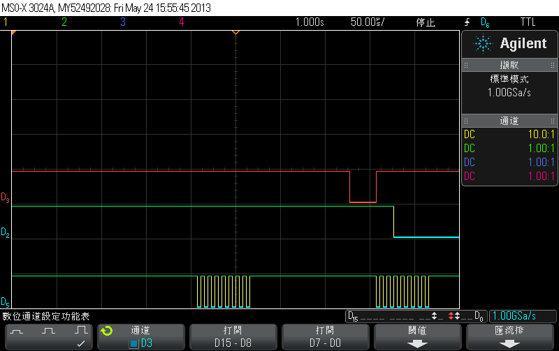

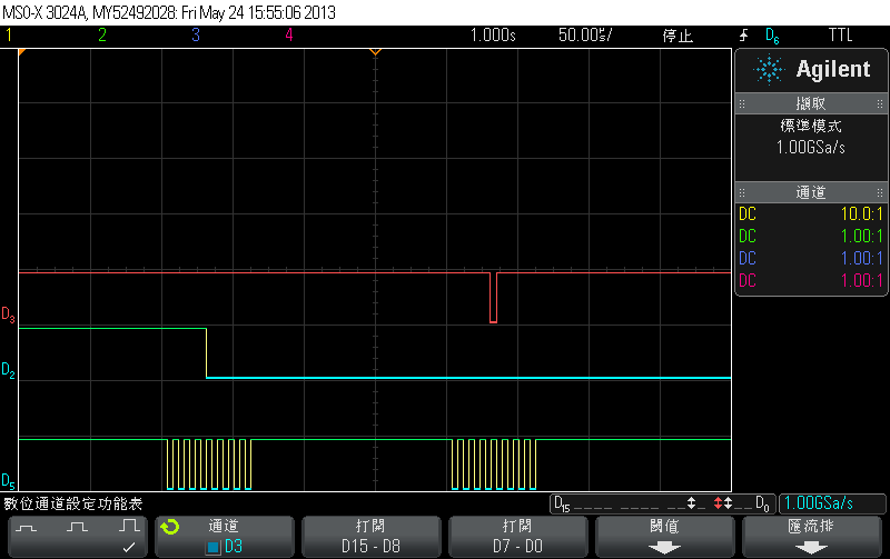

I use MSP430F5529 to control ADS1292R, it converted data in continuous mode,
But the timing seems to have a problem.
Below is a screenshot of the oscilloscope, the first (red line) is the DRDY signal, the third (green) is the SCLK signal.
the command read back currently is right, which means that the command has write into it.
But my DRDY is still not periodic square wave, and the position of the falling edge is not correct.
My program is according to datasheet p.63 written, I do not know what went wrong. I would like to ask what the problem,
thanks!
