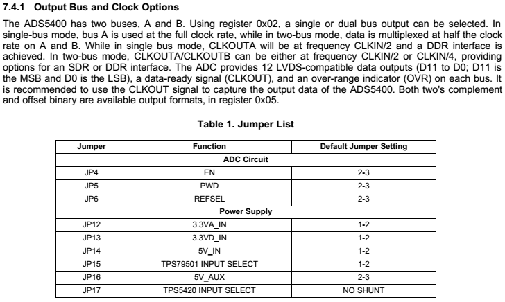

  • Hi Albert, Richard,
    This is great post and answers most of my question, Thank you!!
    Here, I would like to highlight one thing in Richard's reply to Albert.
    "The EVM for the ADS5400 has a jumper on posts for single bus or dual bus selection, so it is easy to choose which interface you want."
    The output format of ADS5400 is selectable either a single or dual bus mode via register and I don't see any jumpers on ADS5400EVM which is related to output mode selection. Here are some quotes from datasheet and EVM userguide.
    Please let me know, if I miss something.
    Ken
