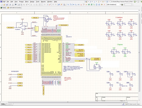

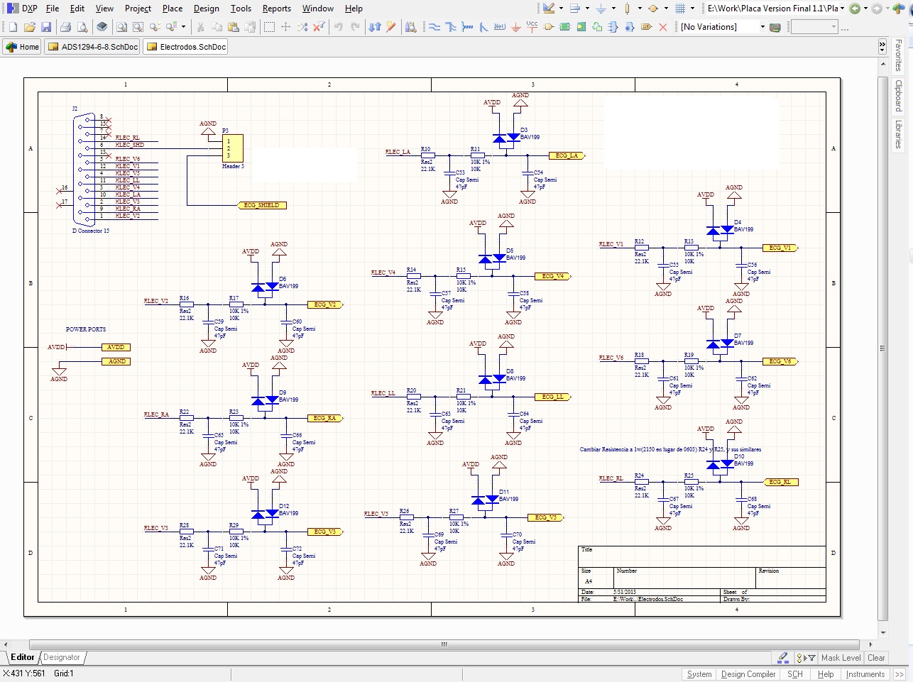

Hi everyone:

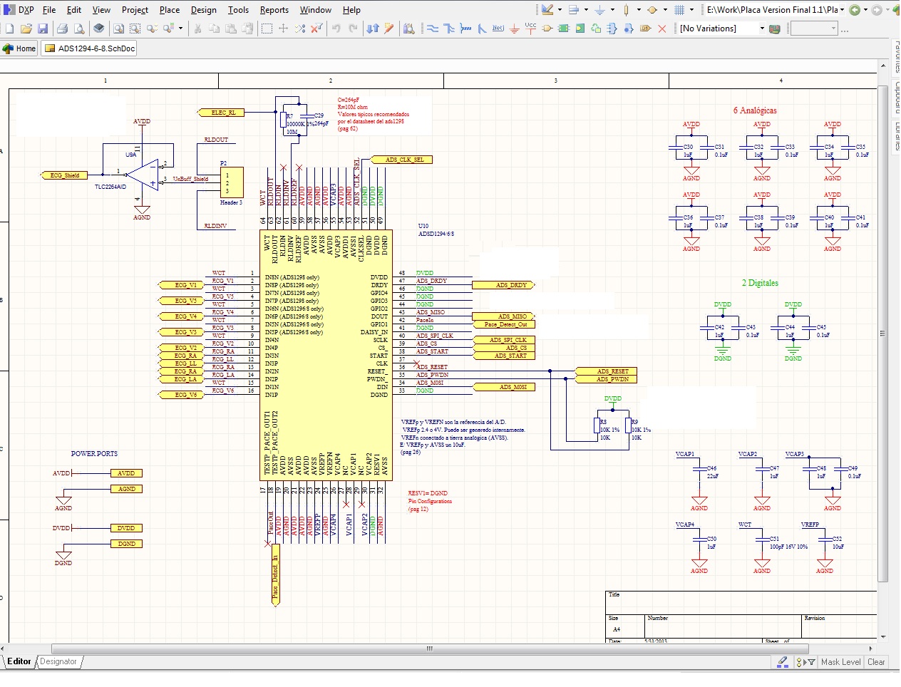

Here is my problem. Lead off detection, pacemaker detection and all function related with ECG are working great but I can't get a value of CMRR higher than 74dB. I'm entering a signal of 16Vpp and 60Hz.  I think the problem is related with right leg drive.The RLD Ad1298 internal buffer could be used with (AVDD+AVSS)/2 or External reference or WCT. I had tested all variants and I can improve the results. Also I had used Appnote "SBAA188-july 2011 Improving Common-Mode Rejection Using the Right-Leg Drive Amplifier" and nothing new is cought. Yesterday I have used and external circuit using TL2264AI and the configuration at page 63 of ADS1298 datasheet. I haven't any ideas.
I'm using MSP430F5529 to communicate with the ADS1298. This is my register configuration.
#define CONFIG1 0x86// 0x06 //Lower power mode         //1000 0110   0x86 high resolution
#define CONFIG2 0x10
#define CONFIG3 0xDC//0xDE//0xDC//
#define LOFF 0x03//0x03//0xF3//0xE3//
#define CH1SET 0x00
#define CH2SET 0x00
#define CH3SET 0x00
#define CH4SET 0x00
#define CH5SET 0x00
#define CH6SET 0x00
#define CH7SET 0x00
#define CH8SET 0x00
#define RLD_SENSP 0x03      // 0x06//
#define RLD_SENSN 0x01     // 0x02
#define LOFF_SENSP 0XFF    //  0x00
#define LOFF_SENSN 0x00    // 0xFF //0x02 // 0x00
#define LOFF_FLIP 0x00
#define LOFF_STATP 00h  //read only
#define LOFF_STATN 0x00 //read only
#define GPIO 0x0F
#define PACE 0x03
#define RESP 0x00
#define CONFIG4 0x06
#define WCT1 0x0a
#define WCT2 0xE3
I have spent an entire month triying to solve this, but I couldn't.  So If someone can help, I would really appreciate it .
