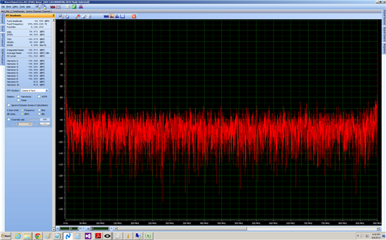

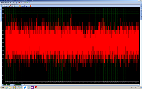

  • Hi Marjorie, I am not quite sure what you meant by "with the dynamic performance parameters pinned open". Here is a screenshot of FFT view attached. The ADC is set to DESI mode. With all the input pins grounded with 50 ohms terminator and I did calibration before acquisition. Everything else was in default status. I also attached one raw data screenshot for your reference.

  • Hi Ethan,
    Thanks for the screen shots.  Sorry my request was unclear before; in the frequency domain view, there is a tab on the left-hand side called 'FFT Readouts'.  This tab will show the SNR, from which we can calculate the NSD and check whether it matcheds the datasheet.  Please either let me know the SNR or attach another screen shot with the 'FFT Readouts' tab visible.  On the top of the tab, you can 'pin' it open.

  • Hi Marjorie,
    Here is the screenshot with the tab open. By clock I assume you are referring to the U12 on the board, which is actually labeled as VM14ABE3-311778EA.  the serial number of the board is SN89, I bought it last year.

  • Hi Ethan,
    Since you bought the board last year, it has the LMX2531 on it; the LMX2541 is a recent update, but the LMX2531 actually performs better, so that is good for you.
    From the FFT Readouts tab, the SNR = 58.67dBFS.  Since the part is in DESI Mode, the Nyquist zone covers 1.8GHz, so the calculated NSD is:
    -SNR - 10*log10(NyquistBW) = -151.22dBFS/Hz
    From the datasheet, the typical NSD = -154dBFS/Hz.  2.8dB is more than I expect missing in chip-to-chip performance variation.  Out of curiosity, how does DESQ Mode perform?

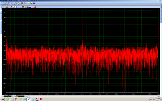

  • Hi Marjorie,
    DESQ mode give SNR=60 dBFS. Is this normal? I am not sure whether I am reading the datasheet correctly. The datasheet says the effective bit would be a bit more than 9 bits, so we expect to lose 3 bits from noise?

  • Hi Ethan,
    This yields a NSD of -152.55 dBFS / Hz, which is pretty close to what I expect and could be considered within the normal variation of the device.
    Yes, the inherent noise of the chip means that the noise floor is at a level which effectively drops the ENOB to between 9 and 10 ENOB for low input frequencies.
