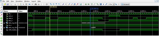

    I am writing the data as 0xFFFF and 0x0000 to the channel 0 continuously  at the rate of 4 Khz.
    But analog out put is not changing according to that. Sometimes it is updating and most of the time data is getting ignored.
    The analog output (Square waveform )frequency observed on CRO is 1.29 KHZ.
    For your reference i am attaching the simulation waveform(On hardware also behavior is same). I am using 27 MHz clock for the interface.
    The Signal Names are as follows:
    SCLK      -->    clk_i (27 MHz),
    SYNC     -->    sync_o,
    LDAC      -->    ldac_o,
    DIN         -->    data_o

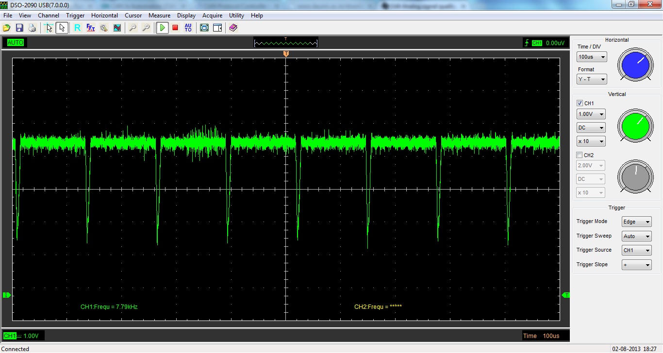

    I am writing these data' s @ 7.8Khz rate. So i should get constant voltage at the output but analog waveform is varying like as follows
    Can you please suggest me to solve this issue?

  • Hello Mahesh,
    Mahesh Hegde said:
    Then I am sending software LDAC
    Data              = X"03FFFFFF";
    The code that you are using for LDAC is actually writing and updating all the values to full scale (5V). This is probably the reason why your output kept switching back to full scale.
    You can set software LDAC for each channel, but you need to toggle it HIGH and LOW manually.
    There is no single code to update all channels without writing to a channel in the same code, but there are a few alternatives.
    Mahesh Hegde said:
    1st channel = X"0308000F";     --- 2.5 V
    2nd channel = X"0340000F";    ---1.25 V
    3rd channel = X"032BFFFF";    --- 3.5 V
    4th channel = X"033FFFFF";    ---- 5 V
    The control bits that you are sending (0xd3dddddd) are for "Write and Update" meaning that the software LDAC is being triggered for each channel immediately after writing to them. If you use this control, a separate LDAC code is not necessary.
    If what you are trying to accomplish is to write all the registers first, and then trigger them all to update at the same time. Let me suggest the following.
    First tie LDAC to HIGH.
    Then you should use the "Write Only" control bits (0xd0dddddd) (DAC8568 Datasheet, Page 38) for the first 3 channels.
    For the 4th channel you should use the "Write One Channel and Update All" (0xd2dddddd) (DAC8568 Datasheet, Page 39).
    As an example using the codes that you used it would look something like this:
    1st Channel = 0x0008000F      -     2.5V         (Write Channel 1)
    2nd Channel = 0x0014000F     -     1.25V       (Write Channel 2)
    3rd Channel = 0x002BFFFF     -     3.5V         (Write Channel 3)
    4th Channel = 0x023FFFFF     -     5V            (Write Channel 4, and Update All Channels)
    Let me know if this resolves your issue.
