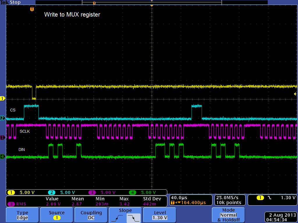

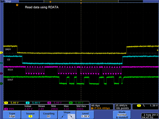

With the ADS1243, is it ok to use a 3.0V reference with Vdd=3.4V?  I am getting unusual readings, rather random.  I can affect the reading by connecting the analog input to the ref thru a 100-ohm resistor so I appear to be reading the correct channel.  I have verified the correct SPI clock phase.  The input is about 0.5V.  Here are some of the readings, MSByte first:

  • Please tell me if these signals look ok.  XIN clock is from the PIC microcontroller, 1.25 MHz.

    The codes you first sent is showing as a negative value.  You need to change the SCLK polarity so that it dwells low.  Data should be read on the falling edge, and change on the rising edge.  With SCLK dwelling high, you are reading and writing the data incorrectly.

    Many thanks.  I changed SCLK to be idle low and that allowed me to read the device correctly.  I still need to sort out the input range etc.
