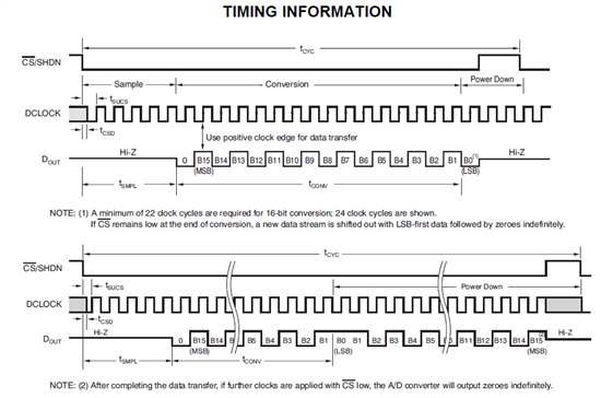

I'm trying to write a SPI function in C language that starts a 16 bits conversion on a ADS817.
According to datasheet 22 clock edges are required :
Here is the code i've wrote so far :

Here i send 3 x 8 clock edges to the chip in order to get the conversion result on MISO line.
For test purposes, V+ voltage is 2.41V and V- pin is grounded.
ADS8317 returns a 3 bytes value but i don't know how retrieve this result (ADC_result) and return it into an integer.
Can someone show me how to proceed please ?
How could i verify that ADC_result value is correct according to V+ pin voltage ?
I wondering the following, but i'm not sure this is correct :
ADC_result = ( 32768 x V+ ) / Vs
Vs supply voltage is 3V.
if V+ = 2.41
ADC_result should be ~= 26208.
Do you confirm this calculation is correct ?
