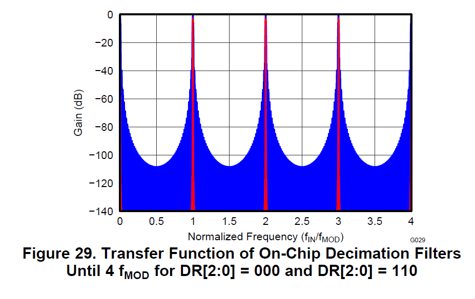

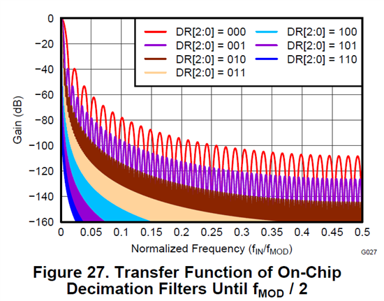

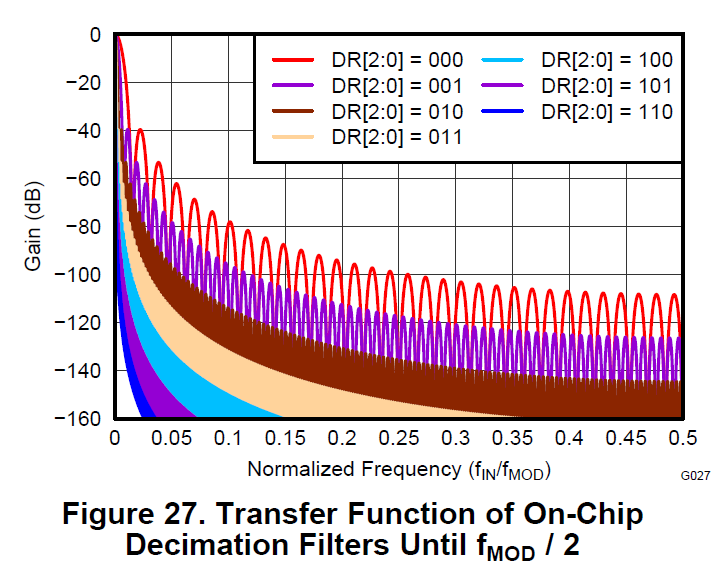

  • I also have a question about a discrepancy in the ADS1299 datasheet.  In Figures 27 and 28 on page 22, the gain vs normalized frequency response of the decimation filter is shown for different possible output sampling rates.  In Figure 27, the slowest output sampling rate is shown as a blue line where DR[2:0 = 110].  The filter responds for this sampling rate reaches -160 dB at a normalized frequency of ~0.05.  The fastest output sampling rate is shown with a red line where DR[2:0] = 000.  The filter responds for this sampling rate levels out with harmonics around -110 dB.
    Figure 29, shows the output for the same two sampling rates, extended for a normalized frequency = 4*fmod.  This figure does not have a legend, and the responses of the two output sampling rates is reversed from the response shown in Figure 27.
  • Hi Troy,
    The use of color was not kept consistent between these plots. In Figure 29, DR[2:0] = 110 is in Red, and DR[2:0] = 000 is in Blue.
    I'll make a note to include a legend in a future datasheet revision.
