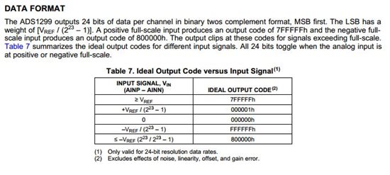

data format about AEF44X0
how to know data format AFE44x0 like below picture
