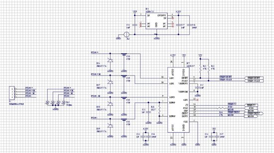

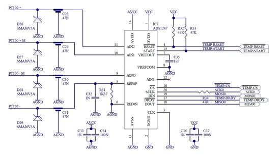

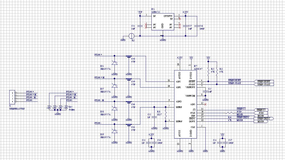

  • Hi Bob
    I have done some further work on the ADS1247 circuit I mentioned earlier and have some questions...
    I have an application where I need to measure temperature to a very high accuracy over a wide ambient temperature range (-25°C to 65°C). Because of long cable length we decided to go the 4 wire pt100 route, because of the negligible effect the cable resistance have on the voltage on the
    measuring wires (2 and 3). I have started development on the ADS1247 development board with the MMB3 dev kit and have obtained good enough preliminary results to go onto the prototype phase.
    Please find attached diagram for reference
    The ADS1247’s AVDD is 3.3V supplied from a precision voltage source, and the DVDD is 3.3V. Resistor R31 (1k37) is a high precision resistor 0.1% with a thermal coefficient of 15ppm. The internal voltage reference was used for the ADC (2.048).
    The temperature range we want to measure on the pt100 is between -40°C and 100°C which will give us an input voltage to the ADS1247 of 126.405mV and 207.765mV. The PGA gain is set to 8 which will give a max output of 1662.12mV to the ADC which will be referenced to 2048mV.
    The ADC should then give a reading of 13569706. These above mentioned results were all calculated theoretically, to prove the understanding and operation of the ADS1247.
    We then proceeded to build two proto-type pcb’s to confirm the above described results.
    The first problem we encountered was the difference between the two pcb’s temperature which we can calibrate out which is not preffered, we decided that that could be because of the IDAC initial error of 6% which will theoretically have a 0.12°C effect between the two different
    IC’s (see attached spreadsheet).
    With the one proto-type, from now on refered to as B1 placed in our temperature chamber set to -25°C for 24 hours, we saw a temperature drift of 0.34°C form the reference temperature measured at room temperature (22°C). We then adjusted the chamber temperature to 60°C and
    obtained another temperature drift of another 0.4°C which makes the total temperature drift 0.74°C.
    We then refered back to the spreadsheet and confirmed that we could expect a temperature drift of 0.56°C because of the temperature coefficient of the internal voltage reference (15ppm / °C).
    We are in the process of changing the voltage reference now from internal to external using the ratiometric approach with a 1.5mA constant current developing a 2.055V voltage reference across our R31. This voltage generated across R31 used for the external voltage reference
    to the ADC is below the 1V mentioned in the datasheet.
    Would this be a recommended solution to our drifting results issue??
    3225.ADS1247 Performance Analysis - 2.xls
    Richard
  • Hi Richard,
    The ratiometric approach is the best.  The basic reason is that you take the current source and related drift out of the equation.  You can do this because the voltage developed across the RTD and the voltage developed across the reference resistor has the same excitation current.  The transfer function of the RTD relative to the reference reduces from a voltage ratio to a ratio of the resistances.  When using the internal reference your result will include any noise/drift of the reference as well as the noise/drift of the excitation source.
    As a matter of the final result it is difficult to just swap in and out RTDs and not calibrate.  The reasons are the differences of the accuracy of the RTDs themselves, and the component tolerances of the devices used on the PCB.  If the total possible error is within a range that is acceptable to you then you should be ok, but usually this is not the case.
    I see from your schematic that you have a number of components for input protection on the analog inputs that are likely to have leakage currents that will change with temperature.  Diodes can be very leaky.  This will affect the measurement result.
    I also see you have no RC filtering at the analog inputs.  You may want to consider adding some filtering, if for no other reason, to filter any high frequencies that may alias back into the pass band.
    Bob B
