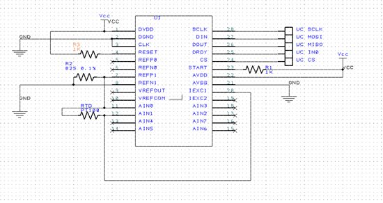

I am trying to get an ADS1248 to talk SPI to a Piccolo to read a 4 wire RTD.  I have the SPI communicating and I am able to setup the control registers but I am having a problem with getting a stable reference input.  I have it wired the same as the example in the app note http://www.ti.com/lit/an/sbaa180/sbaa180.pdf?DCMP=hpa_contriubted_article&HQS=sbaa180-ca.  I have the ADS1248 configures to output 1 mA on IEXC 1 and 2 and use REF0 as reference.  Internal reference is on to activate IDAC current.
Before connecting anything to REF0N and REF0P I already have a voltage differential on the reference while CS is high (3.3V).  This voltage differential drops to 0 when CS goes low.  When I connect the bias resistor and rtd as the app note shows, I get an offset to the reference with a dip in it when CS goes low.  This also seems to have an effect on the excitation current after a period of time, the current drops over time for some reason.  Eventually this current will drop to zero and the ADS1248 will stop responding to all commands.

    Welcome to the forum!  Please send us your specific schematic with all values used and all register settings.

  • Hi Andrew,
    I'm a little confused from your previous discussion relative to the schematic. Make sure you are correctly measuring the REF1 connections and not REF0 as you originally stated.
    If you want 1mA of IDAC current then I would turn off the second source that is unconnected.  In this case IDAC1 register should be 0x80.  If you want 2mA of current, then you should set IDAC1 to 0x88 where both current sources are fed through a single pin.
    For stability, VREFOUT requires a capacitor.  At least 1uF should be connected between VREFOUT and VREFCOM. VREFCOM should also connect to GND.  This is discussed on page 29 of the datasheet under the section Internal Voltage Reference.

  • Hi Andrew,
    If you use the internal reference (which is required when using the IDACs) then you must have a capacitor at VREFOUT.  You should be able to measure 2.048V at VREFOUT with respect to ground.
    How are you connecting things together?  Are you using a protoboard?  How effective is your ground?  Have you checked to see if VCC drops in voltage when the IDACs are turned on?  Any chance you can post a picture of your test setup?
    Initially I would try and keep things really simple.  For example connect IEXC1 (pin 20) directly to the resistor connecting the other end of the resistor to ground.  You should see 825mV across the resistor when the IDAC is turned on for 1mA.  I would not worry about the reference until you discover the cause of the problem with the IDAC.

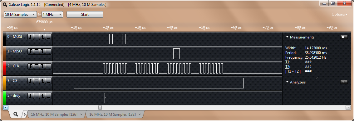

  • Here are the signals for reading MUX1.  I had issued a 0x16 command to stop the continuous read.
    REF1 has the same problem.  When I connect Rbias across REF1 the voltage across the resistor drops 100mV, from 825 to 725 mV.
  • Andrew,
    I'm not sure why you are sending the extra clocks at the end, but the read back of the MUX1 register appears correct.
    When you see the 100mV shift, is the RTD connected?  That would make sense.  Is the REF1 reference still drifting?
