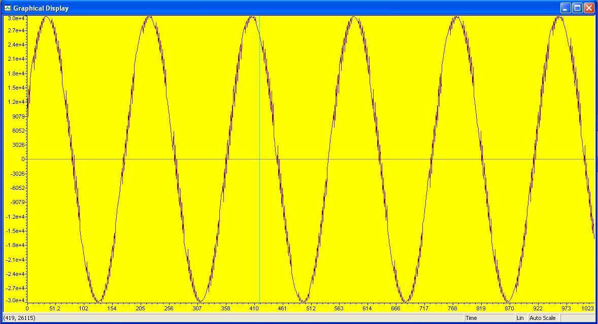

  • Dear Tom Hendrick,
    Thank you very much for your quick reply. My McBSP setting were similar to your example from slaa162 and 1 bit shifting was giving the data right (I think because FWID set to 1). The signal I am receiving is corrupted most of the time in a regular interval. Some times more and sometimes less noise like signal. I can see the sine wave some times clear and sometimes with noisy. I have changed the McBSP settings (FWID set to 19) and shifted 2 bit right but still same type of signal distortion happening. I am including a picture of the signal if that helps.
    Kind regards,
    Shekhar
  • Hi Shekhar,
    With the TMS470 code, the interface was running with an SPI or 'stop clock' type of serial clock. and if I remember correctly, there is an extra clock cycle involved with that setup.  For the McBSP port on the C5510 the way you have things configured, the rising edge of the FS input is what starts the conversion/RD cycle.
    The first falling clock under FS high qualifies the 'read'.  The second and third clocks will contain the channel ID bits and the forth clock has the MSB data.  In your code that you sent me, you are receiving the data, shifting by two, and comparing it to 0x00010000 to do your channel mask.  You don't need that shift - simply change your mask to 0x00020000.
    Next is the data shift on storing to your Channel arrays.  Currently you shift right by two, the shift should only be right by one.  Something like this should work:
    void sort(long data)
      long CH = ((data) & 0x00020000);
      switch (CH)
      case 0x00000000:
        Chan1[indx] = (int)((data>>1) & 0xFFFF);
        count+=1;
        break;
      case 0x00020000:
        Chan2[indx] = (int)((data>>1) & 0xFFFF);
        count+=1;
        break;
    If you still have trouble using that minor set of changes, please shoot me an e-mail and we'll talk more about this off line.
