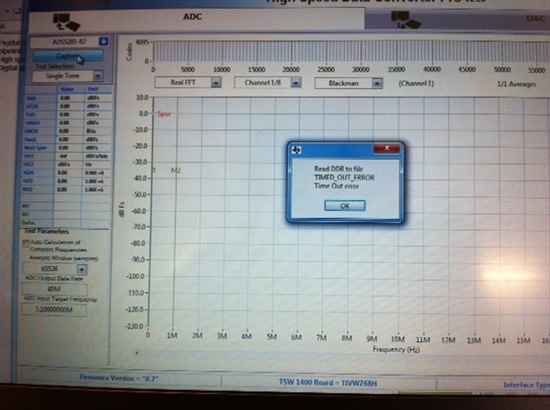

Before trying to capture the signal, the ADS5282EVM is reset (by using TI ADC SPI Interface GUI). After running the HSDC GUI, I can connect to the TSW1400EVM board and the ADC firmware can be downloaded successfully (by choosing ADS5281-82 in the drop down tap, and the D1 LED is lit). The problem is that the USER_LED5 is not lit (the ONLY LED that is supposed to be off is USER_LED4, but they both are off for me). Once I press the Capture button on the HSDC GUI, it takes some time until the error message pops up saying "Read DDR to file TIMED_OUT_ERROR Time Out error".

I just found a file "Error log.txt" in the installed directory. Here is what the file says,
Operating System Name : Windows 7 Professional 32 bit Service Pack 1
Error code : 102.000000
Error Description: Read DDR to file TIMED_OUT_ERROR Time Out error

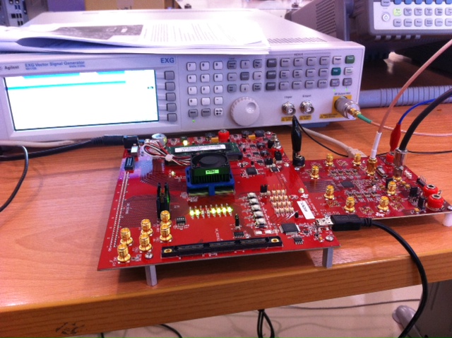

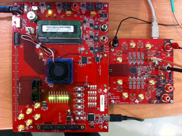

  • Dear KW,
    Thanks very much for the guide. Please see the pictures I captured from the setup today.

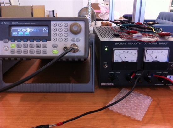

    The error still remains even though I have tried it several times, including checking the power supply and function generator. I do not know if it is a tsw1400's SDRAM connector problem or something else. Do you think the problem might come from the board itself, the setup, or the ads5282 board ? I will also try to contact local TI representative about this issue as well.
    Thanks again for your help.
    RR
    Your setup looks ok and TSW1400 should work. USER_LED5(D7) should be lit up after downloading firmware regardless ADS528xEVM status. Please contact local sales team to check whether another TSW1400 is available. If you need help from my side, please send me an email, k-nam@ti.com.
