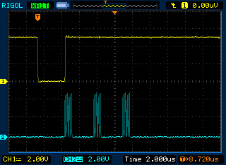

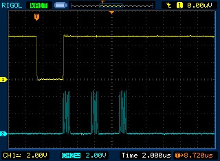

My SPI runs at 4.5MHz and seems to be running ok as seen in the waveforms acquired from my oscilloscope.
CH1: DRDY
CH2: SPICLK

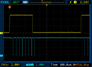

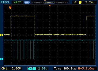

CH1: START (conversion)
CH2: DRDY
My code goes like this. A timer is set to be triggered every 1mS at which the ISR raises the START conversion line. I then receive conversion completion through EXTI interrupts since the DRDY lines are connected to my controller so as to generate EXTI interrupt. After receiving the 7th sample in a batch I lower the START conversion line. After receiving the 8th sample I send the whole batch to my PC through USB. A new cycle starts when the timer is triggered after 1mS. Now what are the odds that I receive a constant error value for all channels in every other batch? I walked through my code for blunders but it is quite simple to make any (I mean I didn't find any!). Since I am reading in channel data read direct mode, I have made sure that enough time elapses between two channel read operations.

    My SPI SCLK is running at 4.5MHz. I am sampling 8 channels every 1 mS, so that would make 8ksps i guess. More over the trace I collected by probing the DRDY and SCLK lines using the oscilloscope (as shown in my original post) the entire (3 bytes of) ADC data is collected well before the DRDY line is asserted again. In short there will be 8 back to back conversions ever 1 mS, yet the oscilloscope trace confirms that data is read in before it gets overwritten by the next conversion result.

    Can I get a scope shot of your /CS, SCLK, and DOUT signals to verify that you are reading on the correct edge of SCLK.
