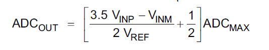

  • Hi Sergio,
    Equation 11 states:
    This does not look correct. Should it look like this instead:
    For example equation 12 is: Vpaceout = 3.5 × (Vinp – Vinm) + RLDREF
  • Thanks Igor, you are correct. There should be parentheses around Vinp-Vinm.
    Sergio
