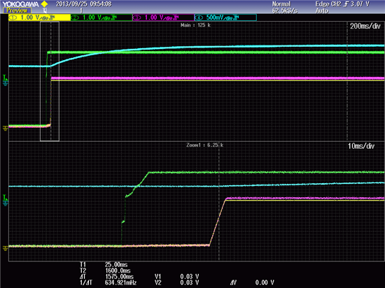

  • Hello Greg,

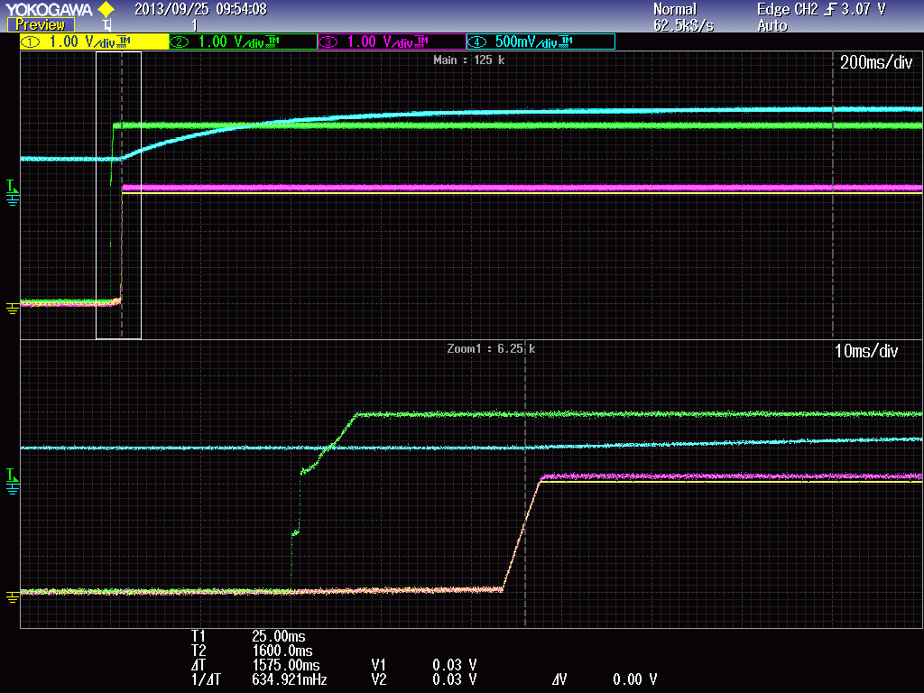

    1) 3V3D and 5V0A are both generated from a system supply. In practice, 3V3D rises about 25 ms after 5V0A.
    2) We did consult this diagram, according to our findings (see below) this timing is respected (with plenty margin)
    3)VCAP 1 is 22uF / 16V 1206 (X5R, AVX 1206YD226KAT2A)

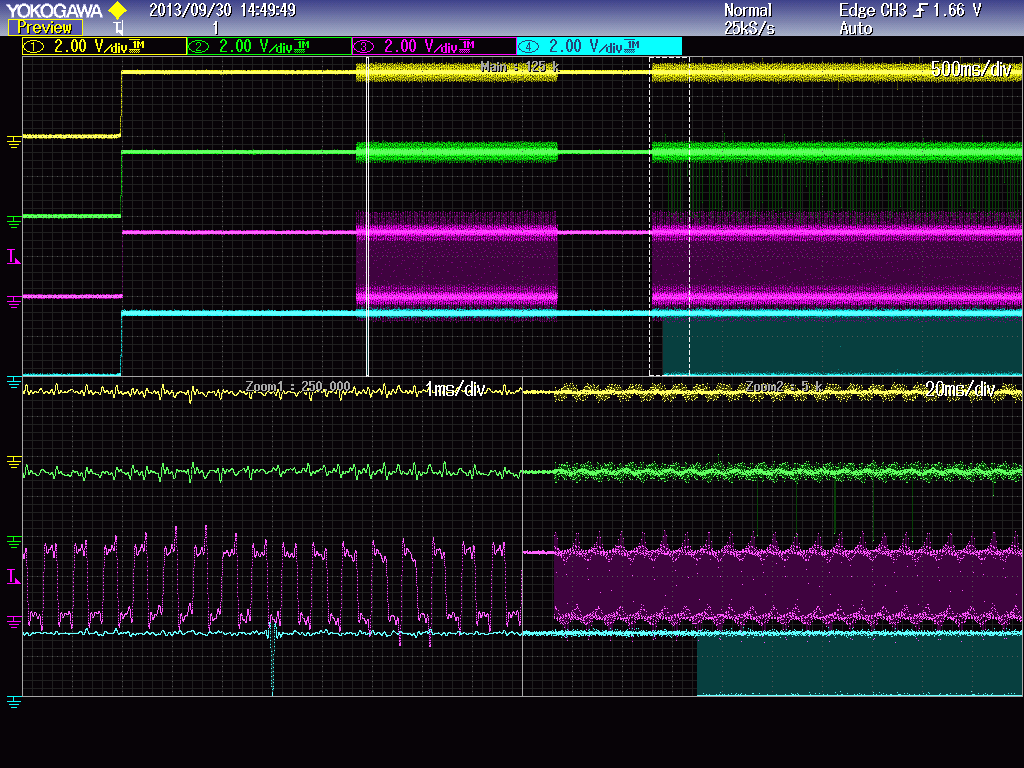

    Picture 1:
    Channel 1 (yellow): 3V3 (digital supply)
    Channel 2 (Green):  5V0 (analog supply)
    Channel 3 (Magenta): Reset
    Channel 4 (Blue): VCAP1
    As can be seen, 5V0A first rises. About 25ms later, 3V3 goes up, along with the RESET.

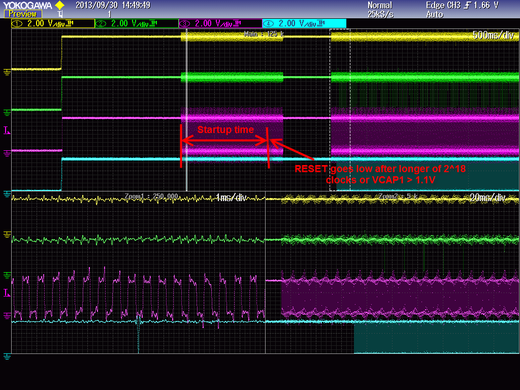

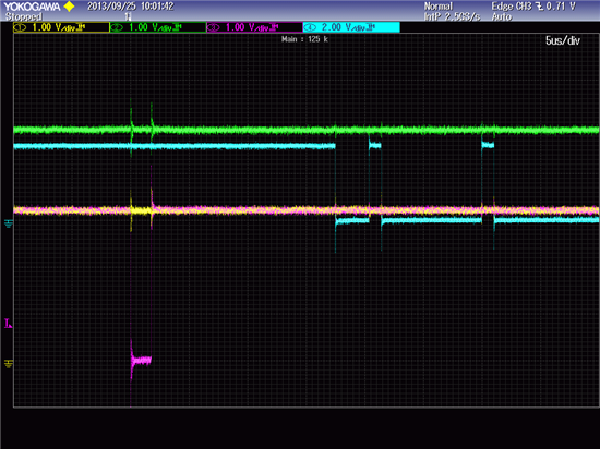

    In this second picture, all traces except channel 4 are the same:
    Channel 4(Blue): CS
    Time between supplies and reset rising edge and first reset falling edge (Tpor) is 1230 ms (FPGA is configured during this time).
    Reset puls width is 1,8 uS.
    Time between reset inactive (rising edge) and first CS edge is 15.7 uS.
    Please let me know if you need more information.

  • Hello Greg,
    I have included screenshots and answers on your questions. Could you advise me further on this problem?
    Kind regards,
    Laurens Tromp

    In the following scope plot things should become a little bit more clear:
    In this picture, the following signals are shown:
    Channel1 (Yellow): 3V3D
    Channel2 (Green): DRDY
    Channel3 (Magenta): ADC clock (not SPI clock)
    Channel4 (Blue): Chipselect
    In the bottom half of the picture, two zooms are shown, from the first and second attempt to read the ADC data.
    As you can see, the first time, there is a CS pulse, indicating communication is performed. I have checked this actually happens, at this scale it is a little bit hard to see because of the undersampling. The second attempt to use the ADC succeeds, as shown in zoom2. In both cases, about 55 ms difference is found between the start of the system clock and the first SPI command. The ADS131E06 does not seem to start in RDATAC mode. Could this indicate the source of this problem? The Start pin is held low by the FPGA. This pin is tri-state during FPGA configuration and kept low as soon as the FPGA starts. In the above picture, fpga configuration takes place when the ADC clock is high and not switching. As can be seen, the FPGA is configured twice in the above picture.
  • The device will only start in RDATAC mode if the device powers up correctly AND START pin is high (or START command is sent).
    In the first zoom, are you expecting CS low to do something?  The device should be initialized using a low pulse on the RESET pin (not CS) at 2^18 CLK or VCAP1 > 1.1V, whichever is longer.  Make sure that the FPGA is sending CLK before you start the start-up counting. It looks like you might be counting the startup time the first time without applying the CLK to the device.  This might explain why things work the second time since the part has had enough clocks between the first and second start-ups.
    Using an external CLK, it is required for the to be present for the state machine of the device to start correctly.
    Your scope shot is marked up to show when the count should be started for the start-up wait and when RESET pulse low should occur.

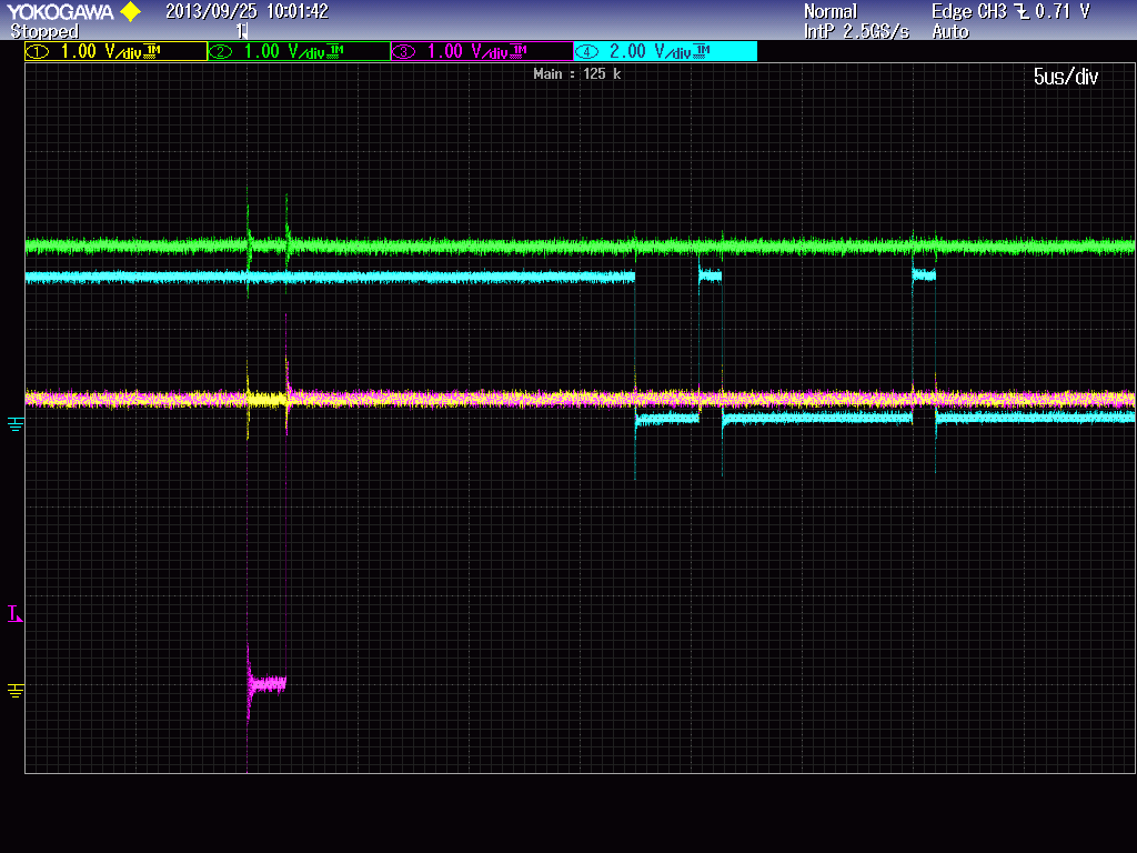

    In the first zoom, the reason for showing CS instead of reset is, that on the given timescale, a 2 tclk pulse cannot be seen. Even the complete initialisation of the ADC, which are 10-20 bytes over SPI, takes place during this CS low. The reason for showing this plot is to show that both times the clk is available for 50ms before the reset is issued. After this reset, > 18 tclk (we have about 15us) is waited, then SPI communication starts.

  • Mr Tromp -
    What is the "strange mode" that you describe?  Behavior?

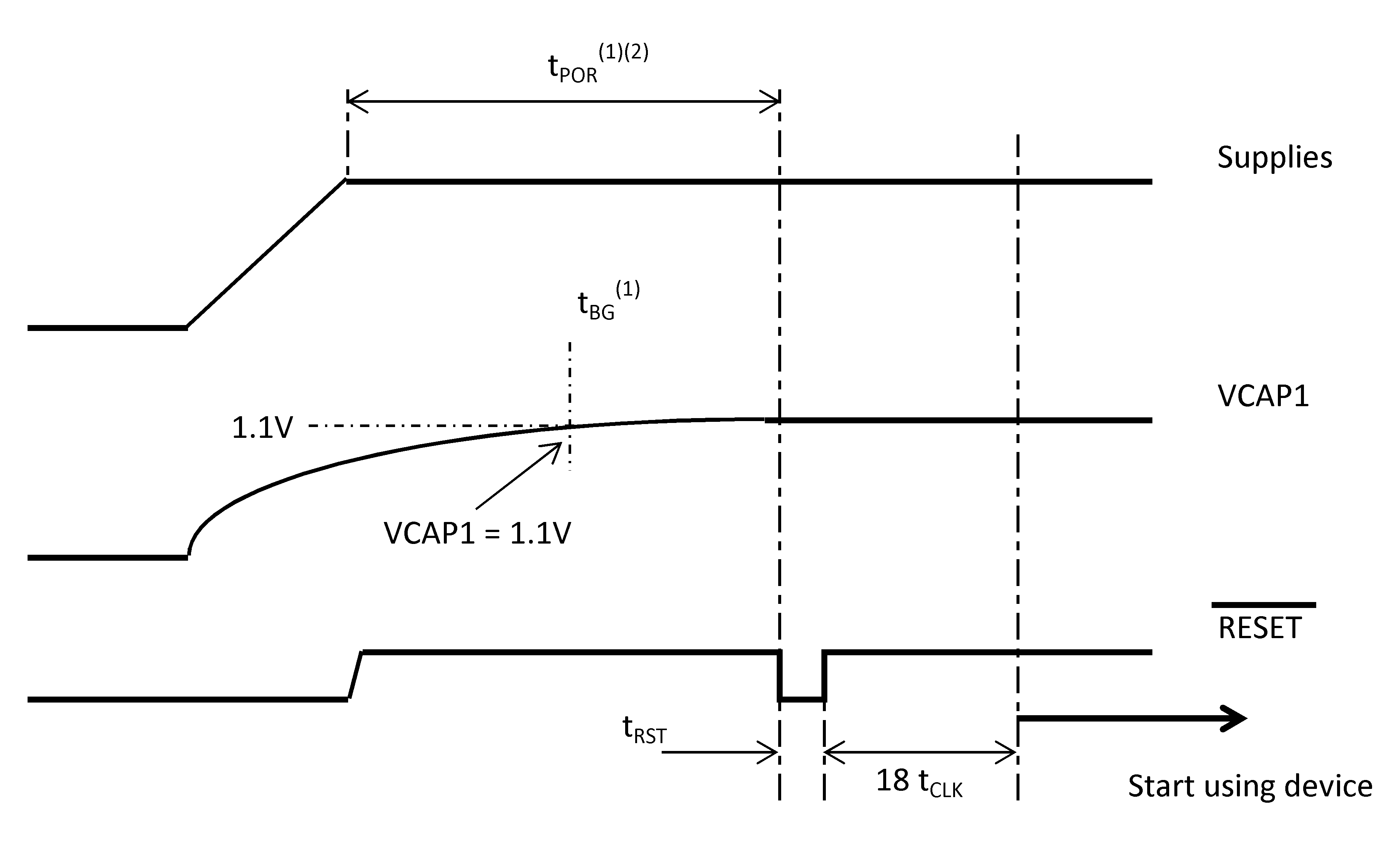

    Can you verify the timing as shown below?  If the device is working the second time, it sounds like an incorrect initialization/not enough wait time the first start-up.
    Note 1:  Reset should occur after VCAP1 >1.1V OR tPOR = 218 tclk, whichever value is LARGER.
    Note 2: For external clocking, tPOR is valid beginning at the time when CLK is present AND supplies are stable.

  • As a level set/double check for ADC startup:
    1. Power up supplies...AVDD, AVDD1, and DVDD
    2. Apply external clock.
    3. Wait 2^18 clocks or until VCAP1 > 1,1V.  Issue the RESET command.
    3(optional test). If you raised START pin, device should begin to pulse DRDY at default datarate and default settings.
    4. For communication via SPI , send SDATAC to device to stop RDATAC mode.  If device was converting, DRDY will stop.
    5. Configure device/send commands as required.
    If the device isn't responding after power-up, make sure you send SDATAC before sending any commands or register read/writes.  Otherwise, the part may ignore any communication.  Step 3 in above is a quick check in that once the device powers up, if you raise START pin, it should start pulsing DRDY (at default settings).  If you don't see this without anything further, we may need to investigate the connections or future debug.
    If you still have problems, can you send either a schematic of your hardware or block diagram with connections, so that we can make sure everything is OK.

  • A quick recap to make sure that we are on the same point:
    1. Power up supplies of the device.
    2. Start external clock or use internal clock.
    3. Wait 218 tclk or until VCAP1 > 1.1V, whichever takes longer.
    4. Send RESET pulse (> 1tclk wide) or RESET command.
    5. Wait 18tclk before using communications with the device.
    From the description, it sounds like maybe you are still experiencing some timing issues on the initial RESET.  If the RESET command/pulse is sent too early (before condition 3 is met), the signal is ignored and therefore the extra 100ms you are waiting is the time for the part to start-up on its own.
    Let us know if this is still confusing or if things still don't work properly and we'll get you up and running.

  • Mr Tromp -
    To clarify -
    Condition #3 was from the graphic and notes in the previous post dated 07OCT13.  This is a change in the upcoming datasheet revision and the graphic and notes in the post are what will be included.  This was to clarify start-up/power-on potential issues that have been noted for applications where the VCAP1 capacitor was designed with a large capacitance value.  When using a 22uF capacitor, most designs to not have any problems.  However, for large capacitance values, there were occasional invalid device configurations at start-up.
    These proposed changes will take into account the potential variations in the capacitance and allow for correct timing for RESET signals to be applied.
