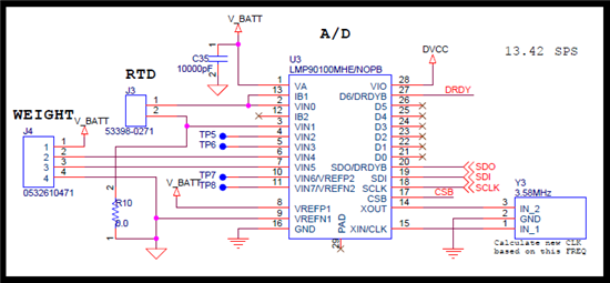

Hi, I'm working with the LMP90100 and am running into a problem I was hoping to get some help with. The IC works beautifully on channel 0 (an RTD connected channel) but when I take data from Channel 1, currently the only other channel in use, I get a value that is consistent withing the board, and does not change with an input. The value that the LMP90100 is "stuck" on varies between boards. SPI communications work, I have written and verified registers, and as I said before another channel is behaving correctly. My connections are below:
My register settings look like this:

        0x46, //CH0_CONFIG, ODR min for data reliability to reduce on-time for current source, gain = 8,
              //buffer enabled automatically, can be disabled to save power at cost of precision
        0x25, //CH1_INPUTCN: VINP = 4, VINN = 5, rest same as CH0
        0x4F, //CH1_CONFIG: ODR Max, Gain = 128, variation of strain gauge = 7.2mV variation from 0 to max.
              //buffer off

I've set the data output rate pretty low temporarily to be sure the mcu can keep up with the A/D while I'm dealing with this. I'm hoping for some help because I'm pretty stumped and would like to move on to the next stage of development asap.
