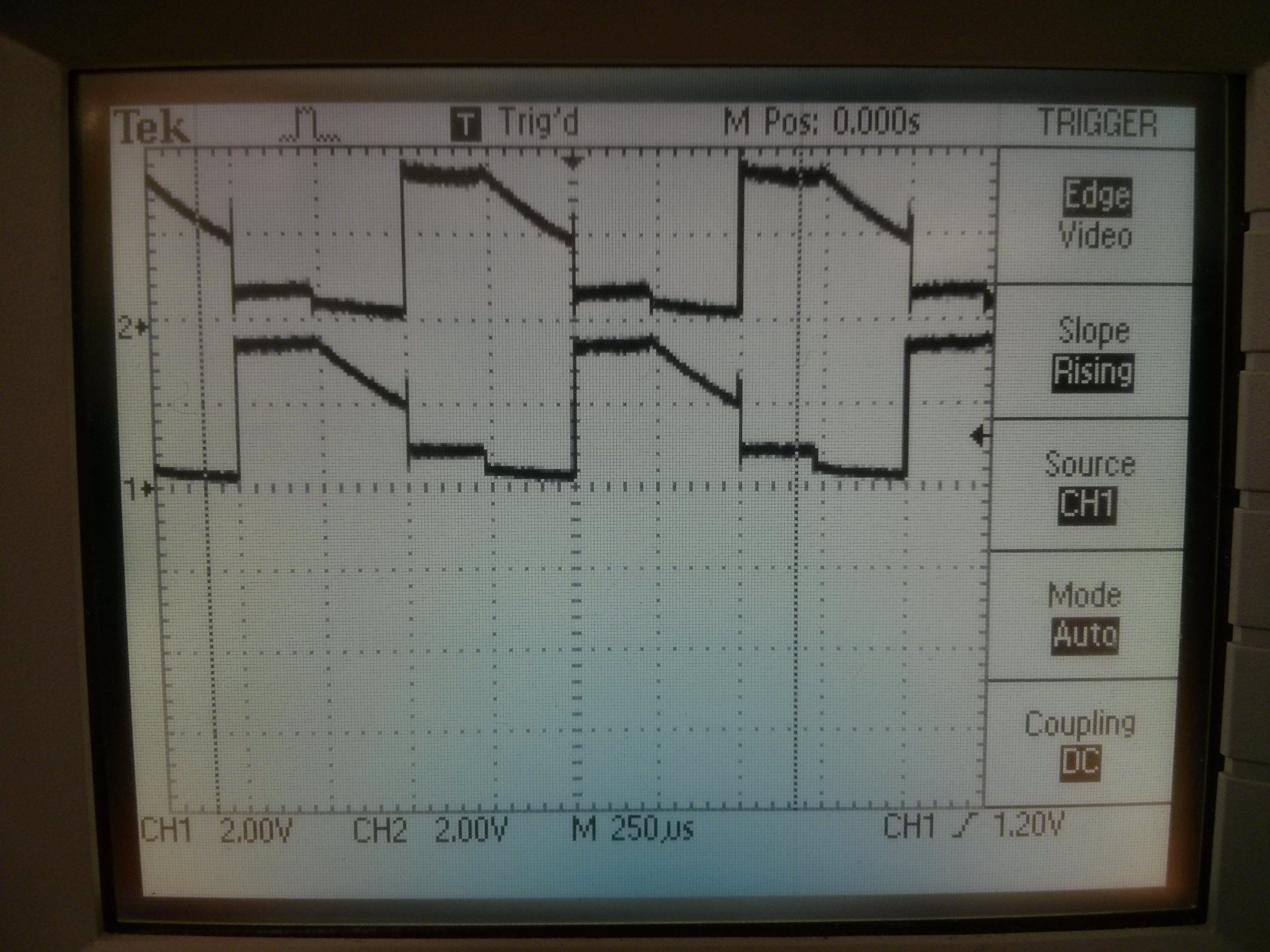

  • Hi Praveen,
    Thanks a lot! You are completely right, I missed this at the latest schematics revision. Now I can get a pulse train (attached). Is it how it should look (signal ramping down slowly looks a bit suspicious)?
    Maxim
  • Hello Maxim,
    As far as the decaying waveform of TXP, TXM is concerned, the tx switches internal to the device are turned off and so no current actually flows through the LED.
    ~Praveen.
