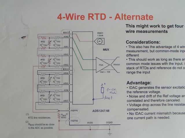

  • I make some changes: Current source1  is used for PT100 1 an2, and current source2 is used for PT100- 3 and 4
    is it better?
    Is it possible to get some good PCB design for ADS1248?(working one)8561.Mj_temp2.pdf

  • Hi Zlatko,
    Happy New Year!  Can you send me your most recent schematic?  Is the START pin high when writing the registers?  Can you send me some pictures of the SPI communication when changing the MUX?
    Bob B

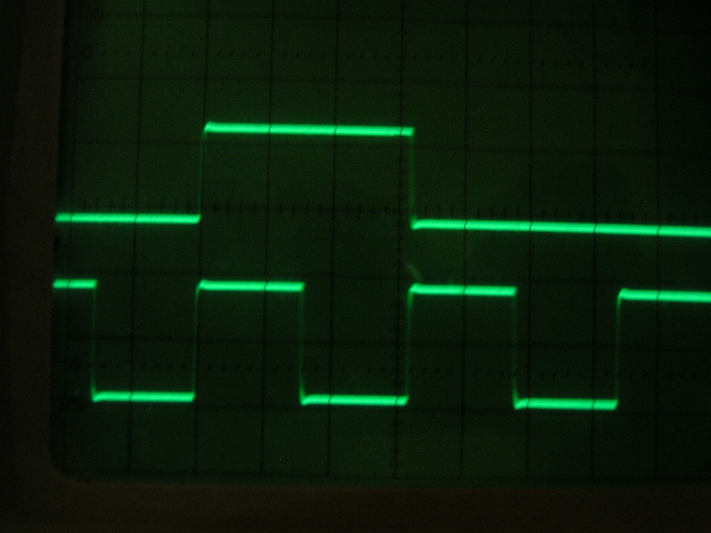

  • Start pin is Low.
    Schema is 8561.Mj.temp.pdf- I send it  oct.10.2013.
    I attached pictures  data_in ws clock while sending
                       SetCS (0);
                             Send_SSP0 (0x40);
                             Send_SSP0 (0);
                             Send_SSP0 (0x01);// set inputs +Ain0 - Ain1
                      SetCS (1);
    data ws clock
    I have only 2 trace scope.
  • Hi Zlatko,
    Looking at your schematic I see that there is the potential that the digital pins can float.  You probably should add weak pullup or pulldown resistors (100k) to the digital signals that connect to tri-state buffers.  Also, for the ADS1248 device to convert and to read and write registers the START pin must be in the logic high state. The START pin controls the power down status of the device.  Please read the section 'SPI Communication During Sleep Mode' on page 37 of the datasheet.
    Bob B
    I put START pin HI and ist OK, many thanks for help!
